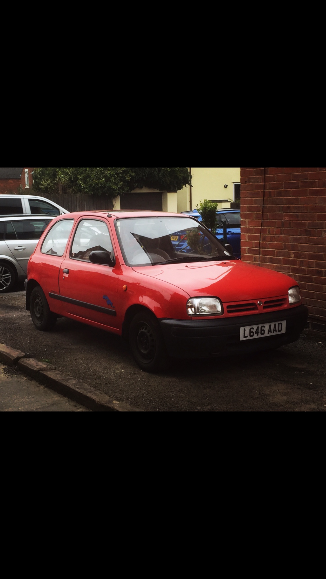

K11 Lowering options + ride and handling qualities.
Hi.
I know there are many threads on the ins/outs of how to lower a k11, but I've struggled to find many reviews of the ride quality and handling.
For example the alto/matiz rear springs swap when compared to a dedicated k11 lowering spring set.
If there are any of you who have experienced several spring/shock upgrades then I'd like to hear your subjective findings.
I'm after probably 35-50mm drop with a firmer but not harsh ride. Sportier but not rough. Tyre sizes will remain near stock, may reduce profile slightly.
I'll point out I'm not considering coilovers as my experience with my 200SX is that of limited service life and comparatively high maintenance for a 100% road use car.
Also not going to be doing any spring cutting- not right IMO.
Also are items like stiffer Anti roll bars and lower chassis braces easily available?
Thanks in advance!

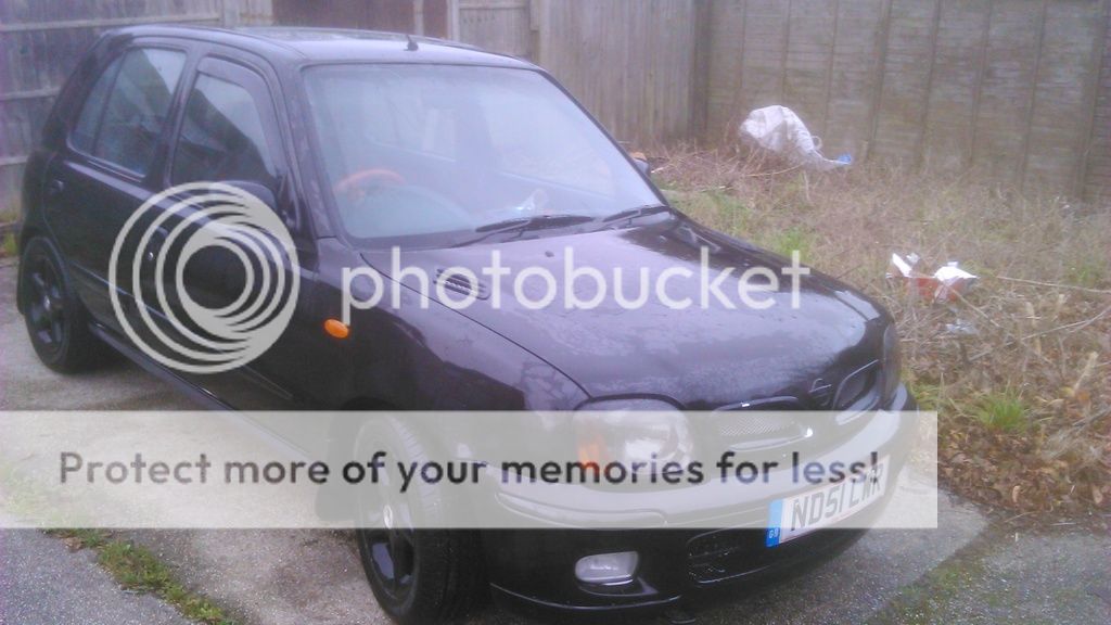

That's a better picture!! Because obviously they do go down once you've put them on brand new I imagine? Yours looks quite smart at that height
It's the angle of the photo and the wheels, standard 14" wheels with 155/65 snow tyres versus 14" 6J alloys with 185/55 tyres.
Them wheels do look good! Does it ride okay and everything on them springs? No problems with speed bumps or anything?
Spot on, no issues at all with ground clearance, they've been on for nearly 7 years now (I think) I prefer the ride to the standard set up, it transformed my car.
Ah okay! Sounds promising, tempted to get them now you've said good things about them. I haven't changed my wheels yet there just standered 14s so I think they should be okay
