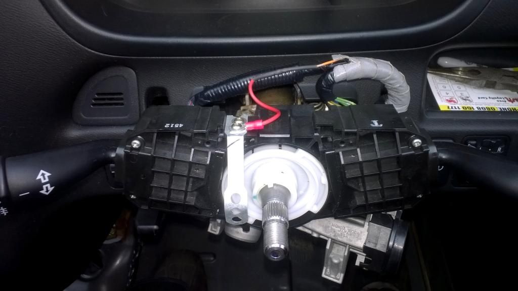

I then unscrewed the SRS airbag thing (Black and Yellow) hidden behind the wheel, undoing four Phillips screws in each corner. This requires the steering wheel cowl being removed, by two screws underneath the cowl.
Removing the airbag thing will stop your indicators self cancelling, and also stop the horn working. To keep you horn, you need to perform some electrical wizardy which I haven't done yet, but will do and will update this when it comes to it.
It will then look like this

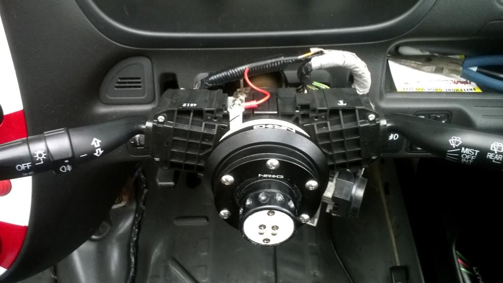

6) Fit your new wheel onto the boss, and fit it onto the splines ensuring the wheel is in the straight ahead position.
Tighten the center nut to 35Nm (Basically till it feels snug)
And voila, you will have a super awesome wheel

I never did get the horn wired to the wheel.... At a rally (that's what I use the car for) a scrutineer pulled me up for not having a horn, so I quickly just wired the horn to a button on the dash.
If you want to do the same, it's a very easy job, just find the horn wire ( I believe it's blue) and wire that to the switch, and then ground the other wire. I'll post a link to a good guide on fitting a horn to the wheel.

The trick to making horns work is a sprung connection, it's really easy. Find the horn wire, attach a piece of metal to the column so that it will push against the metal on the boss, connect the wire. Simple as that!
