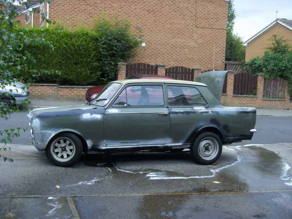

Vauxhall viva? I hope you still got it, cool cars man. We had an hc & a hb way back in the day, i always wanted the viva magnum myself but try and find one, no chance. :doh:

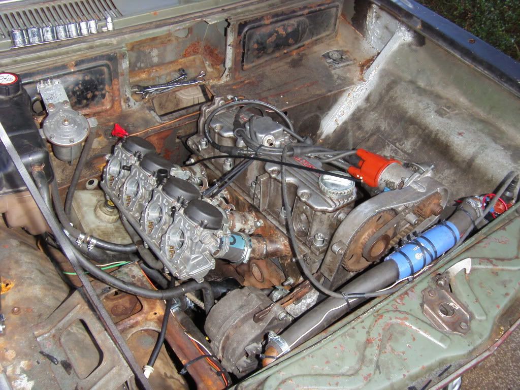

I dont have the viva anymore. It was a ha running c20ne engine on bike carbs with a ford type 9 box and mgb gt rear axle :D
