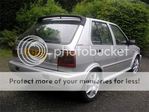

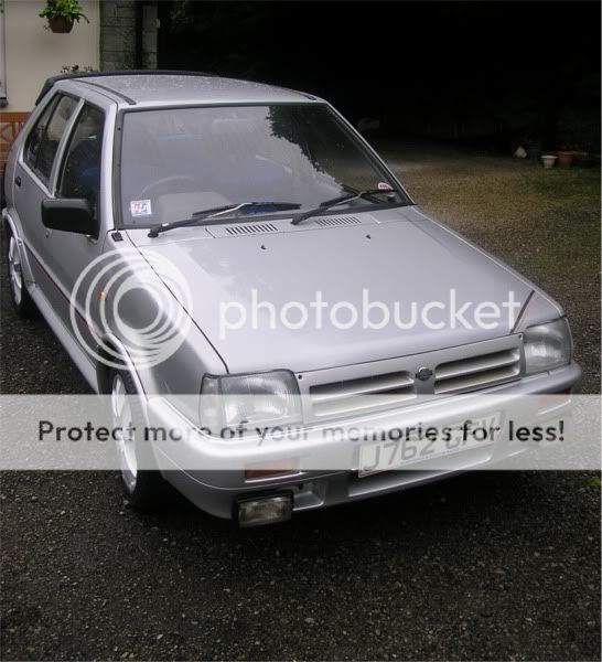

There's photos of a 5 door silver K10 on here somewhere with a super s kit fitted. The arch was cut, and a bit bolted to the door, and was a really good job.
Here it is........
And one from the front.................
I cant remember whos car it is but its a lovely example
It's a genuine Micra spoiler, i've seen quite a few in scrappys - and yeah that's the K10
