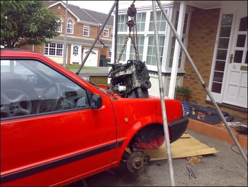

As you can see in this picture, the disc isnt held on by anything so should come off pretty easily, if not give it a tap around the drum part of the disc (the part that goes around the hub) and the face of the disc (where the wheel bolts on)
IT'S COME OFF HOORAH!!!!! i just heated it up a little and gave it one almighty WHACK and off it came THANK YOU PEOPLES it looks like they are the original one's and have never been taken off before so i will be replacing them with newer one's THANKS once again
