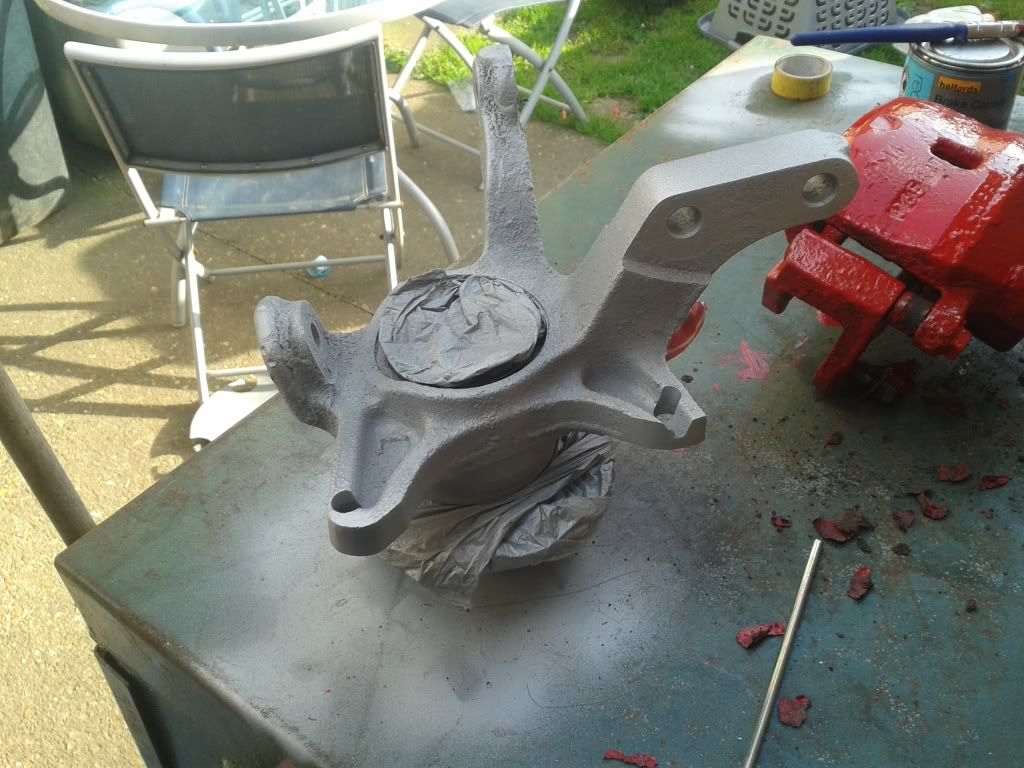

I can take pictures of my hubs and show you how mine are modified to take Gti-R brakes :) biggest upgrade you can really do :)
that would be great! take some pics and just tell me what year pulsar gti-r calipers and rotors u used. I am definetly goin to do this upgrade but need the how to and what works from u guys. cuz no one here in Canada even thinks of modding micras! I am fully equipped to cut grind weld mill machine anything so just tell me what and how u did ur upgrade. thx
Here's one :)
Not much meat left on that bottom bolt hole eh Andy :eek:
That ones not done :( realised after I'd painted it. Ive drilled the hole out of alignment by 2mm... so once its done... I'll add approx 5mm of weld to beef it up.
I'll get a pic of my other :) you'll like that one
(Had to make new ones... I might have cut one by accident a little while ago :rolleyes:
ok cool I get the idea of how u cut the old caliper mounting ears off ground em down and drilled hose for the pulsar bracket. but what year rotor and caliper did u use so I know what to order to start mocking things up. and just to be clear this is all used with the stock master cylinder right?
Yup stock master cylinder. They use the same banjo eye and bolt too so you can use the stock pipes
Between years 90-94
