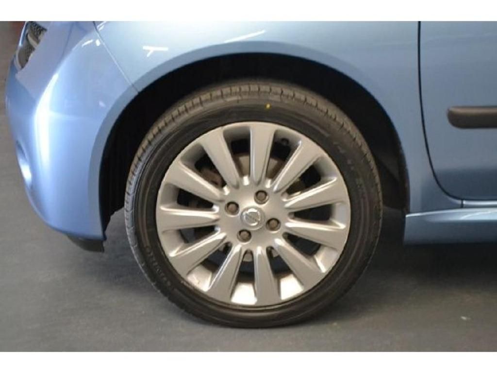

In case if you need alloy wheels to your vehicle, I have set of 6x16" 160SR wheels available.
I started "Start a Conversation", there is phone number ;)
Wow nice! I love this place. I got the original receipt of the car from 2003 and discovered my Micra did have alloy wheels when it was bought, but unfortunately has part ways with the wheels at some point of her life. It would be so awesome to have ones. I replied to your message.
