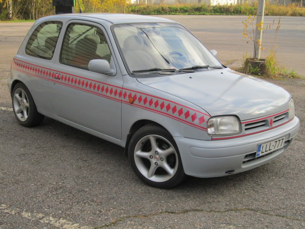

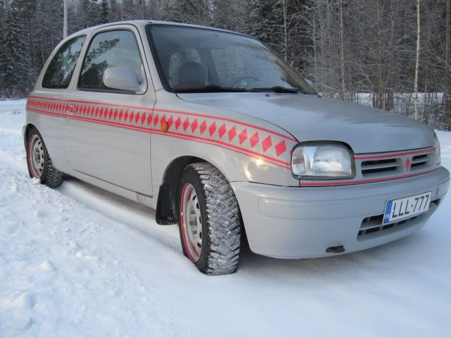

I´m a new Club member. I have owned my -95 K11 1.3 now six years. It´s been fun and reliable little thing to drive. I´ve done few mods to it, most of them during this year.
When I bought the car it was dark Green with standard 13" steelies and nothing special done with the looks.

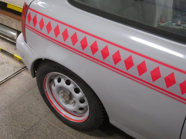

I liked green colour too but when it was time to make some rust repairs, we decided to add a theme to it. So after rust cleaning I sprayed gray paint and added taylor made stickers. Theme is Jussipaita, traditional Finnish shirt. Could be translated Johnny-shirt.
Both front seats are now covered with Jussi-shirt and the Dude has got one also :)

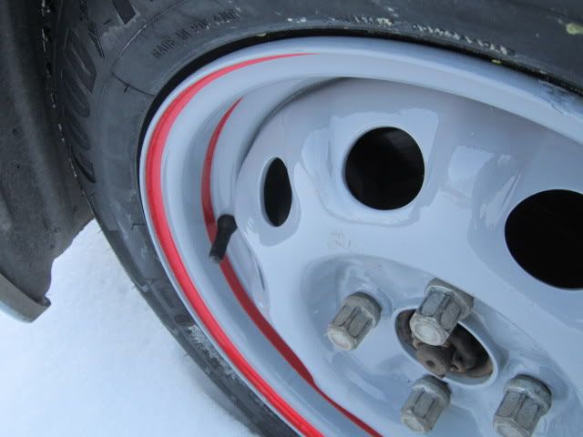

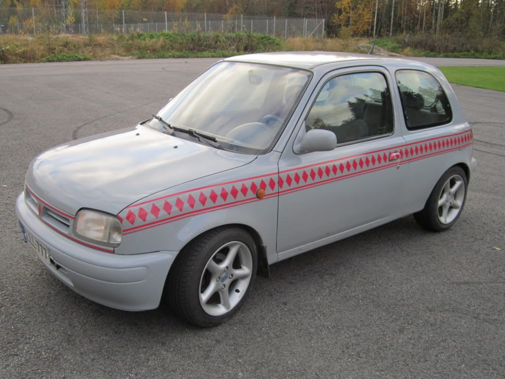

Last winter I had a bit slippery tires, so I bought 15" wheels (Opel). I Grinded, primered and sprayd couple layers gray and two layers clear coat.
Wheels would be ok imo, but 185/55R15 winter tires was hard to find and they are expensive. So I have to sell those and get 14":s. 175/65R14 is common size and 100 € cheaper. They are also better to drive in the winter imo.

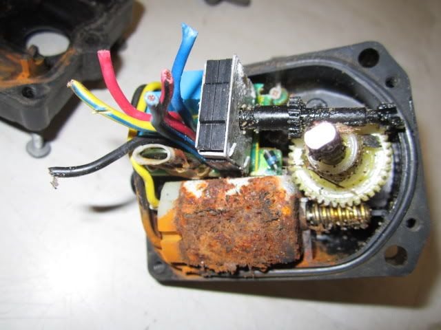

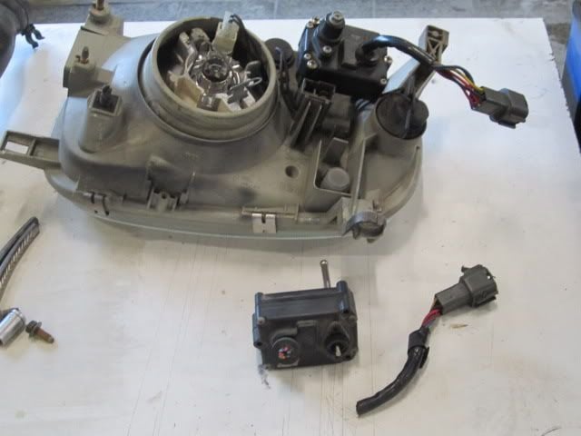

My LHS driving light adjust motor´s been dead two years. Old motor´s insides looked bit rusty.
Found a spare motor, it´s Almera N15´s piece. Almeras motor looks similar to Micras. So I replaced it. Motor started working nice, but when left light went up, right went down lol… found out its RHS.
Then I had an idea to switch couple cables, didn´t work. So I have to keep searching for LHS motor.

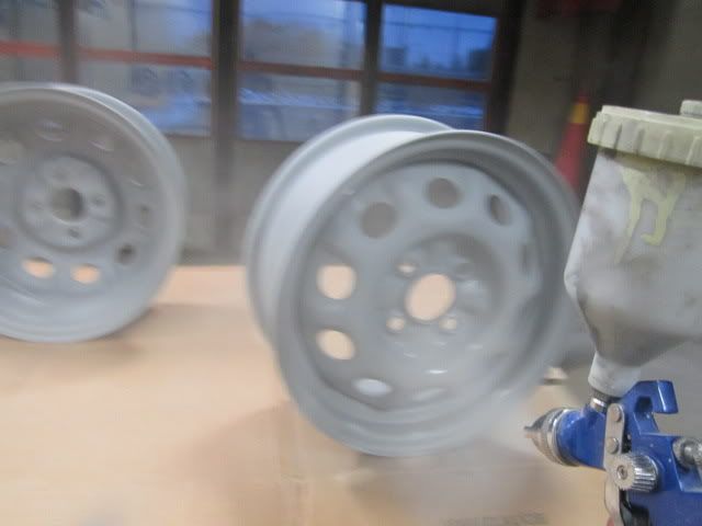

I´ve already got 14” steelies back from sandblaster´s shop. He sandblasted and epoxy primered them. Yesterday I painted them gray and they got a bit lacquer also. 175/65R14:s are waiting in the shop.

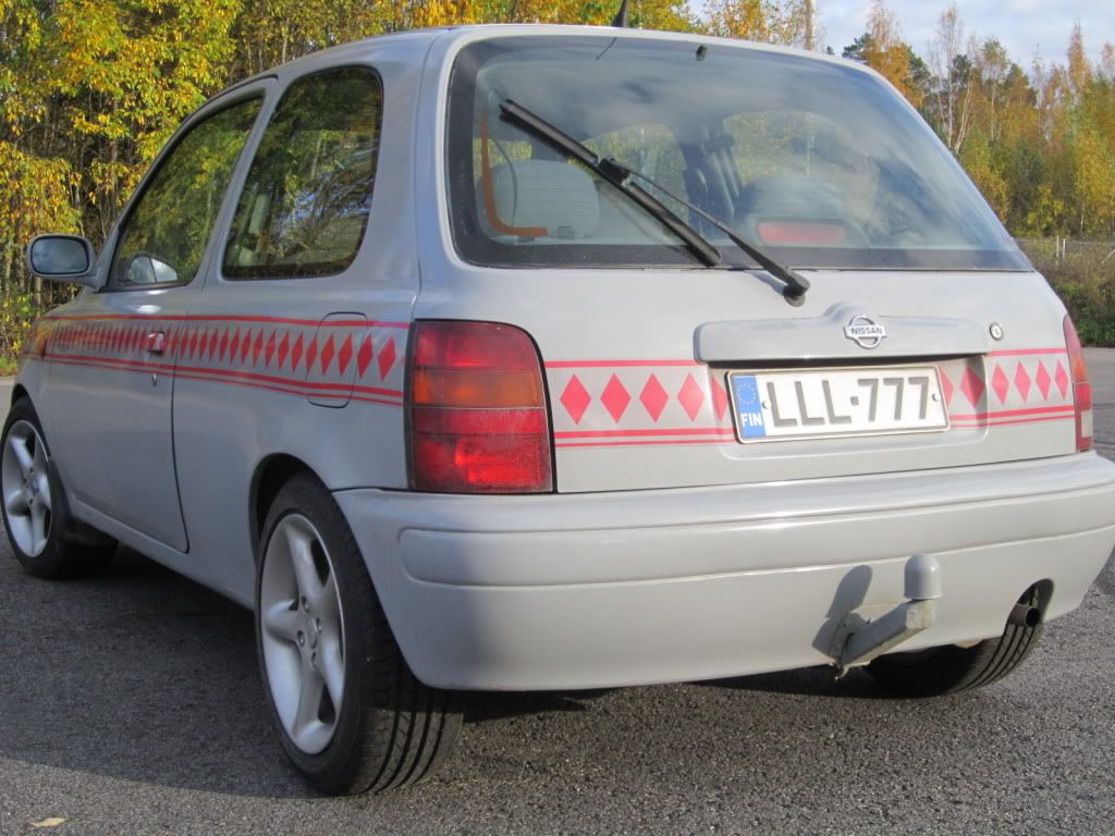

I don´t think that towing bar makes car more beautiful, but I need it sometimes...althought like they say in Finland: there can be loaded only greetings on a trailer with this car :p .
I spent another lunch break with the driving light adjuster. Got another motor and it´s finally working right way.

Had to check reg. papers tow capacity: 310kg without brakes, 750kg with brakes. it´s not bad at all, there´s many trailer options especially with brakes.
Checked out tow bar prices from Motonet, 189.90€. Checked also scrapyard list: http://www.autopurkaamot.com/. There was many K11:s but not any tow bars. I think that cars with tow bar don´t crash :p . Maybe I should ask discount from insurance company :eek:
Might consider that new bar also, one with a removable knob would be perfect but i´ve not seen them on K11 so it´s a hard to get maybe.

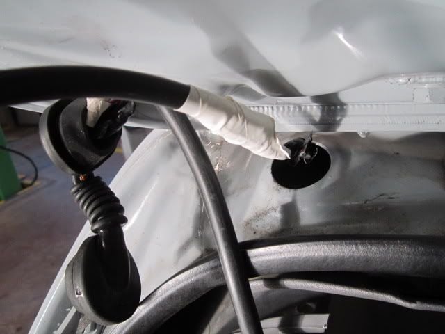

One day in last summer I was driving from work, slight wreath of smoke came somewhere behind steering wheel. I stopped at a bus stop and everything worked ok, so I kept on driving. Finnish summers are quite bright so I didn´t notice there was few lights missing until my wife went driving, I saw backlights didn´t work at all. All fuses were ok, did find some melted wires under the dashboard. Had to take whole dashboard out and replace many wires from dashboard to all the way to boot. (Did lost: backlights, platelights, front parklights, gaugelights and even gauge bulbs, few wires, daylight relay)
In Finland we have to keep lights on even in daytime, many cars have daylight relays. Common problem with these Nissan relays is that one headlight goes off, but when turning the lights on both headlights work. I opened that relay and found jump cable in it. I think it was the reason why fuses didn´t burn at all. Some pre owner or garage had done one “clever” repair in there, instead of linking jump cable between lights in the front (Asked price for a new Nissan relay, was 400€. Scrap yard´s cost 40€). Found another problem, that was my mistake –plate light wire was in short circuit, was chafed against the boot handle bolt. Handle was out before and I didn´t put it together properly, obviously.
I repaired other lights in summer/fall, but reg.plate lights didn´t get my attention until now.
Didn´t manage to get the cable through C-pillar, so had to do usual “tape-trick” with it. Did cut old cable and taped properly new and old together, then just pulled that package down to boot. Replaced all boot lid wires. Finally all lights are working.
