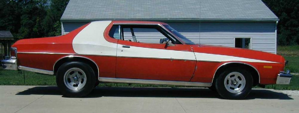

Don't know if you read this "The rear ends were lifted by air shocks, and had "U.S." brand 5-slot mag wheels added with larger rear tyres." (extract from wikipedia)
Yeah I know thats how they did it, I was just using it as an example of the angle i want:
On a short wheelbase car like a k11 it should just be a matter of a little drop and a little lift.

For an authentic look you'll want to stagger the tyres as well, drop a profile on the 155's or use 165/55's for a fairly big rubber drop on the front, and a big chunkey rear with a larger diameter to lift the rear.
Don't forget to mount a brake or fog light on the centre of the axle! White letter the tyres! Oh my god how cool would it be if Autoplas were still making rear window louvres!
I "almost" decided to strip and polish my slots and make some vinyl stripe as a homage to the red tomato up there.
