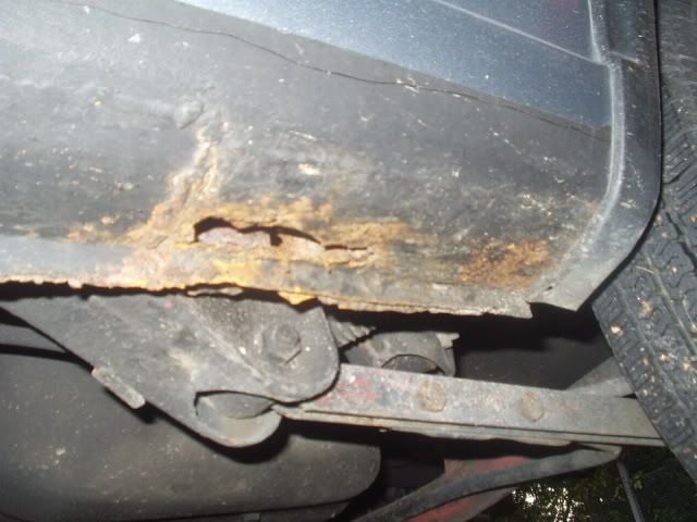

Micra 110 Site Supporter Sep 12, 2008 #1 Considering this 'Welding' was done only last year it hasn't lasted that long... Got a funny feeling I might have to get a new sill for this Job....maybe not...but rats anyway

frank Club Member Sep 12, 2008 #3 prevention is better than cure . 50 - 50 mix of shutz and old engine oil http://www.micra.org.uk/attachment.php?attachmentid=10519&stc=1&d=1221242454 http://www.micra.org.uk/attachment.php?attachmentid=10520&stc=1&d=1221242454 http://www.micra.org.uk/attachment.php?attachmentid=10521&stc=1&d=1221242454 Attachments PICT0120.JPG 87 KB · Views: 381 PICT0119.JPG 105.8 KB · Views: 369 PICT0123.JPG 88.4 KB · Views: 354

nexussteve The reason you're happy! Sep 13, 2008 #5 I've just under-sealed most of mine with tetrosyl. Most of it went on the sills, and under the new wing I put in. Everyone should do it. It's a mucky job, but for the price you pay, you'll be thankful in the long run!!

R RTLkyuubi Ex. Club Member Sep 14, 2008 #6 doing any repairs or rust proofing is completely pointless if you dont get rid of every spec of rust 1st!

frank Club Member Sep 14, 2008 #7 RTLkyuubi said: doing any repairs or rust proofing is completely pointless if you dont get rid of every spec of rust 1st! Click to expand... i beg to differ with that, you CAN stop rust from spreading

nexussteve The reason you're happy! Sep 14, 2008 #8 Rust is oxidation afterall. If air can't reach it, it shouldn`t be able to spread...technically...
R RTLkyuubi Ex. Club Member Sep 16, 2008 #10 you will only be able to slow it down, as there will be oxygen / moisture trapped in between the flakes it will carry on. unless you treat it (either cut it all out or use some of that anti rust gel stuff) then it will come back.
