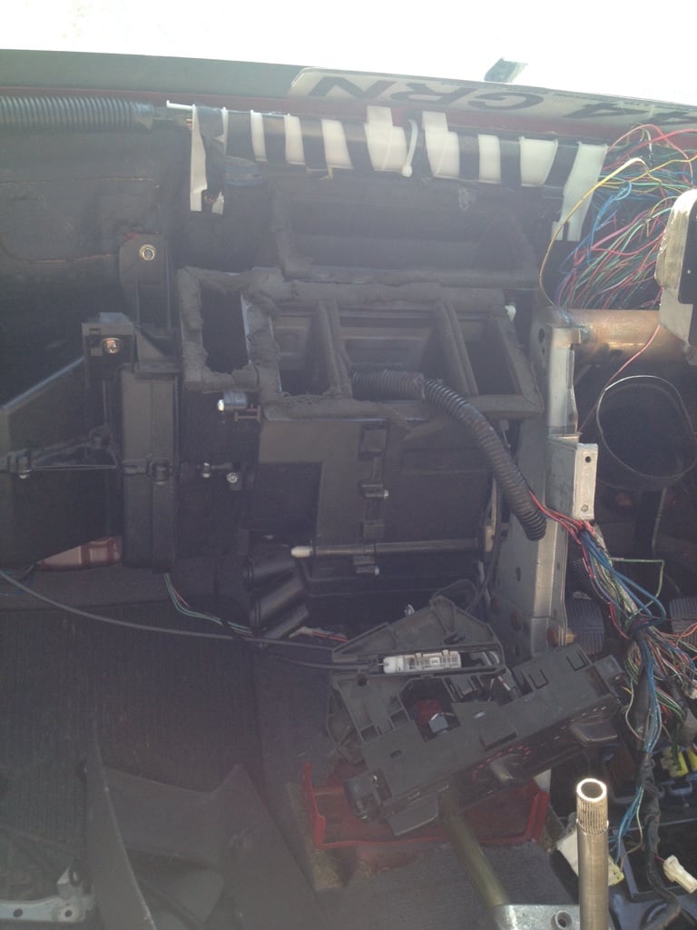

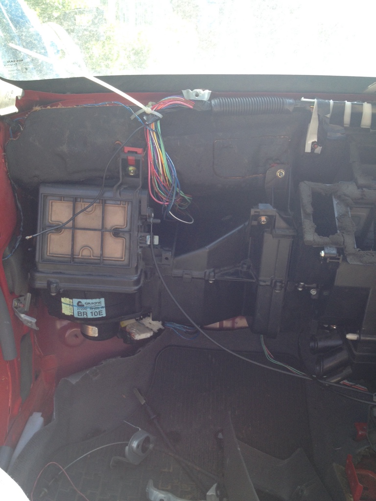

Hi guys ,can someone tell me if the pao heater assembly is the same as a micra k10. Mine went on me tonight. Is it a dash out job? Thanks.

Being based on the k10 chassis I'd guess they were, do you have a picture of the pao assembly?
Thankyou azzydot for the photos but its not the same heater. The K10 heater matrix is thinner and wider aswell so unless my radiator guy can fix it I shall modify the heater case to fit the k10 matrix as I can't find a pao one anywhere. The dash came out in a very compact unit with all the ducting,great design work from Pike. I just have to remember to drop the column next time doh!
Thankyou azzydot for the photos but its not the same heater. The K10 heater matrix is thinner and wider aswell so unless my radiator guy can fix it I shall modify the heater case to fit the k10 matrix as I can't find a pao one anywhere. The dash came out in a very compact unit with all the ducting,great design work from Pike. I just have to remember to drop the column next time doh! View attachment 43187 View attachment 43188 View attachment 43189 View attachment 43191View attachment 43192 View attachment 43187 View attachment 43190
