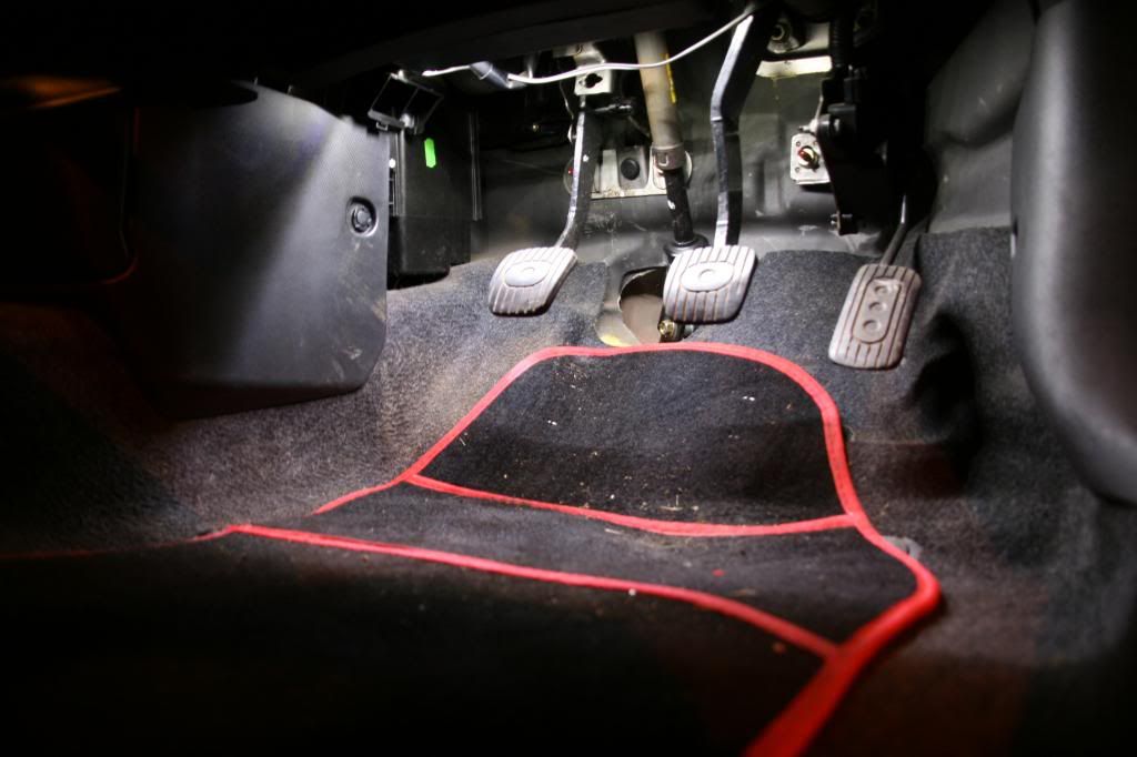

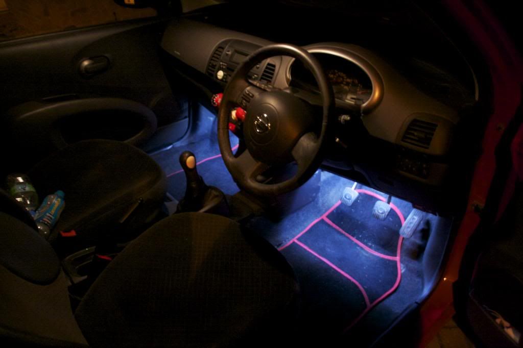

A very long winded, but hopefully easy to follow rough-guide.. and i took a couple of pictures of the finished look - they're actually pure white...

Interesting...I guess you'll be wearing your pretty shoes when you drive from now on? :p
seriously though looks cool...do you think it will be distracting whilst driving?...or is it just corner of the eye like the CD display etc?

Problem is it also shows how grubby the car is 90% of the time...
