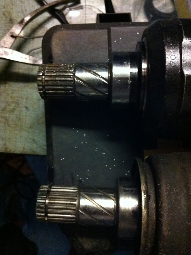

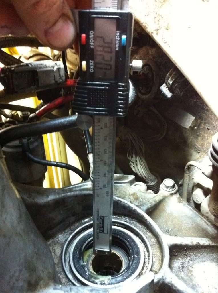

Hola. Been trying to resolve my shaft oil leak issue which is making me pull my hair out. After changing several seals me n the old man have been trying to find out the issue. Fitted new se from Nissan. Ran the car up. 10 mins later oil leak. The short shaft n/s was able to pull it out by hand. The shaft was floating back and forth. The circlip was not keeping the shaft in place. After several trial and error methods to see if can sort it the old man suggested maybe it's the incorrect cv joint on inner shaft. We measured inside the box how far in the circlip should go before 'clicks in' and how far the shaft circlip is located.
Photos below. Have I got an o/s inner cv fitted or is there something wrong with the gear box peeps??

k few pics from me spare 1.3 driveshaft and diff
the circlip on my 1.3 driveshafts are 43.6mm from the edge face
the seal and the driveshaft surface are 40mm dia
this is my old 1.3 open diff after fitting my lsd, to see how it all fits
at the inner edge of the planet gear the shafts slot into, you see the groove at the end of the splines, this is where the circlip clicks into. and its the same 43.6mm from the ends of the diff face as on the driveshaft
Thanks for the picture. Your description makes perfect sense. I'm off in garage now with a coffee and a fresh mind to have another look.(Y) need car done today!!
Tried remeasuring again today pollyp and seems I was looking at the incorrect area for the circlip to connect. Put circlip back in again. Slightly opened up soba bit tight going in and also did franks mod the same time. Run the car for 5 mins, no leaks. Went for a skid up the mountain. No leaks. Must of been the shaft migrating in an out allowing oil past the seals. Thanks all for your help!!(Y)

in your first pic looks like you were not measuring deep enough, thought i'd keep quite and let the experts sort you out :grinning:
The recess in the end of the diff is where I thought the circlip was meant to fit. Blonde moment. Can't believe so many issues sealing a driveshaft
