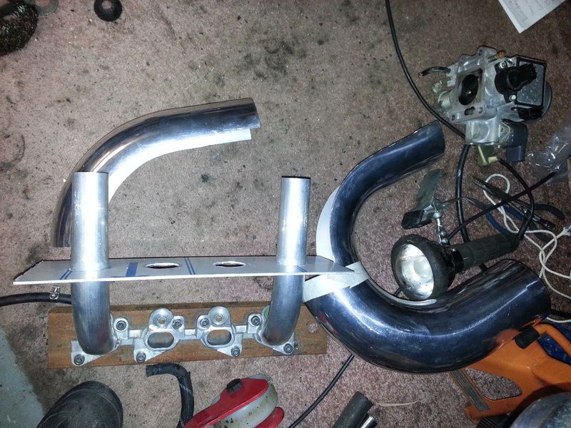

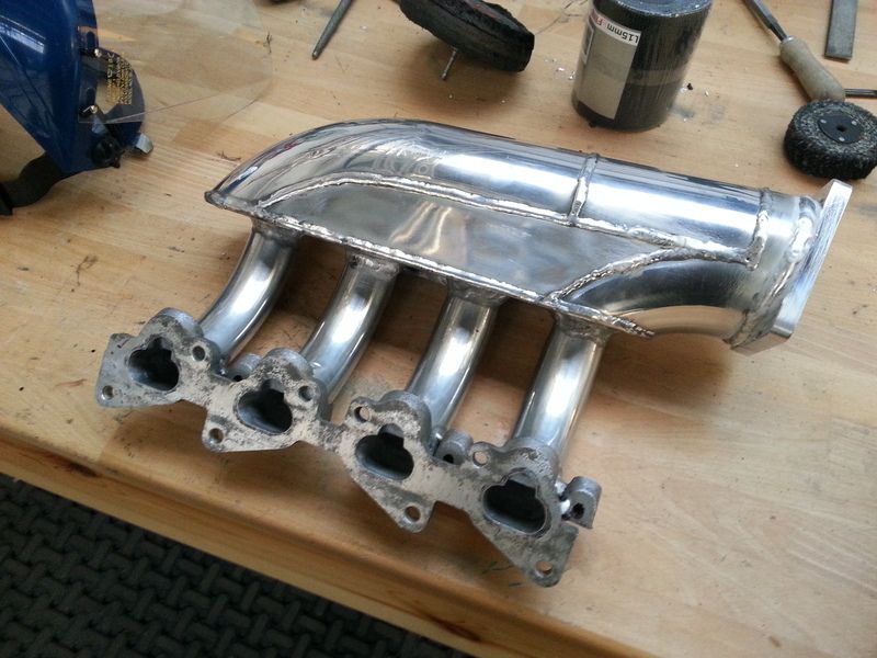

Fusion Fabs do an inlet for this conversion. I did my own.
Maybe some day. all my spare time is spent on my mini conversion at the moment. Also need more practice on the TIG.

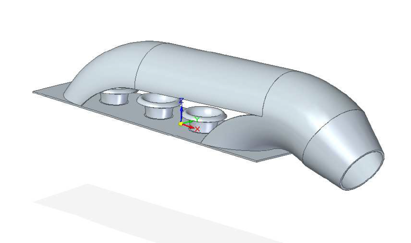

CAD model was useful for dimensions on some of the curved surfaces.

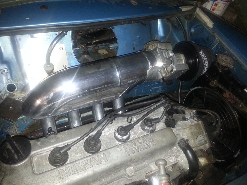

Some more photos. I can't claim the idea for the design as a copied it from a photo I found on the Internet.
I will be asking lots of questions when time comes to get it running as I'm a bit worried the fueling will be too lean.
If I didn't have access to a TIG welder then I would probably have gone for the Fusion Fabs one. I can understand why they charge what they do as there is a lot of time spent on making something like this.
