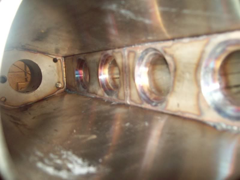

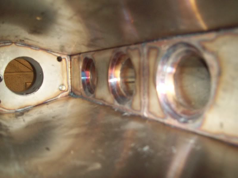

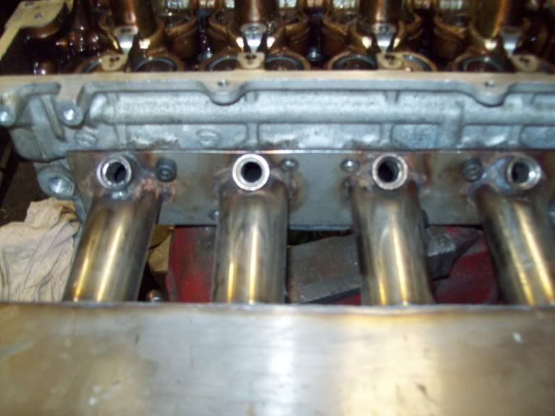

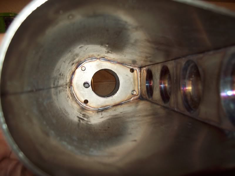

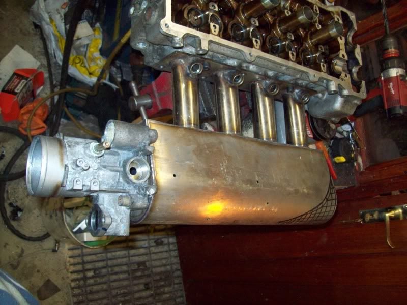

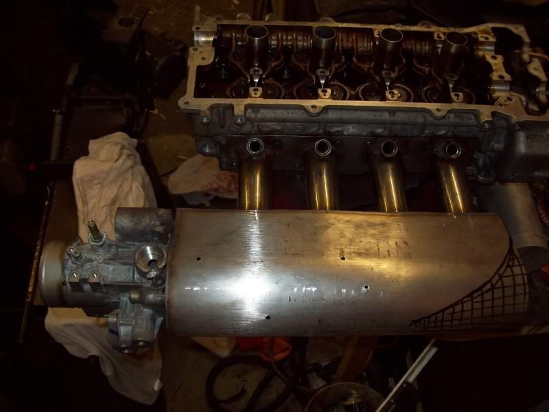

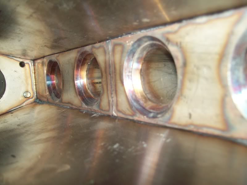

with these cold endless dark winter evenings, ive been searching for something to waste my time on, so been doing a bit of fabing, as the title suggests its an inlet manifold, pics are in no perticular order

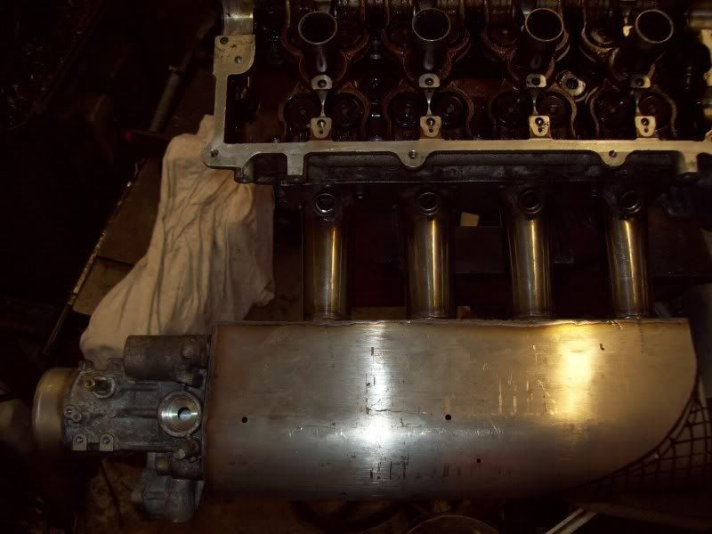

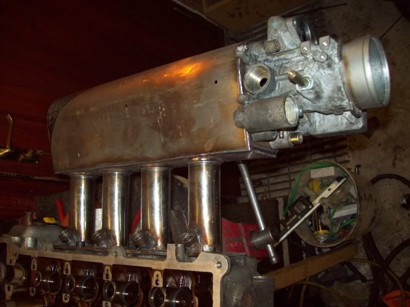

pics shown with my bored throttle body, hatched bit needs removing to clear master cylinder, this wasnt a mistake i knew it would need the corner chopping off to clear. :)

Is that stainless then? Some very nice fabrication, have been waiting for these pictures.
Just a few questions: Is that a measured plenum chamber size? and runner length? are you going to use the cga fuel rail with that? if not what are your plans for the fuel rail?
You should be very happy with that mate, looks fantastic!
Nice work (Y) But did you measure it so that when it is in the car it wont foul on the firewall?

yes mate stainless, its was more of a project to try my new (to me) tig welder out, some of the welds are a bit ropey but i was learning as i went along
its an educated guess at volume, stock is about 1.1-1.2 litres, alot of places i read said about 1-1.5 times enging cc for NA and 1.5 to 2 times for a charged motor, this is about 1.9-2 litres, so is roughly 1.5 times engine cc, which might be a bit large for na but my plan is to charge it anyway so thought id make it on the large size, runner length is not even an educated guess, its 1.5 inch od pipe as that gave the best shape for the port and allows me to open them up by around 1mm all round, and the length is the longest i could get in before it hits the bulkhead.
no im using a modified cg ruel rail, should have taken pics of it really, basically ive cut off the mounting brackets and the feed pipe, the brackets will be new and the feed pipe needed moving, so essentially it will be the same sort of setup
i am very happy for my first attempt at tigging :)
yes mate i did measure it, it should just fit, fingers crossed tho as its going to be mightily close but shoulf not foul.

did you consider using bent inlet runners to allow for longer ones?

@noddie, just re-read your message, no i didnt consider bent runners until i bolted it to the head to take pictures and thought thats going to sit low down, if it does clash with the firewall ill bend them up.
