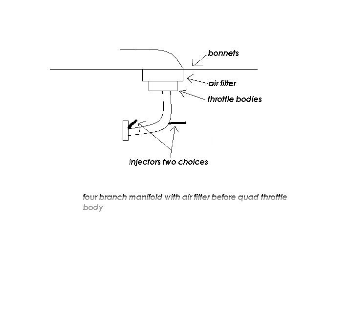

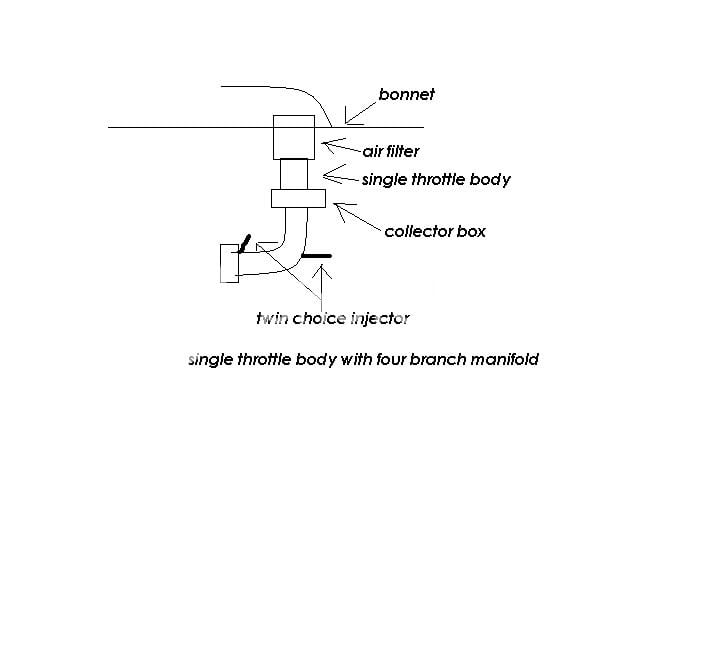

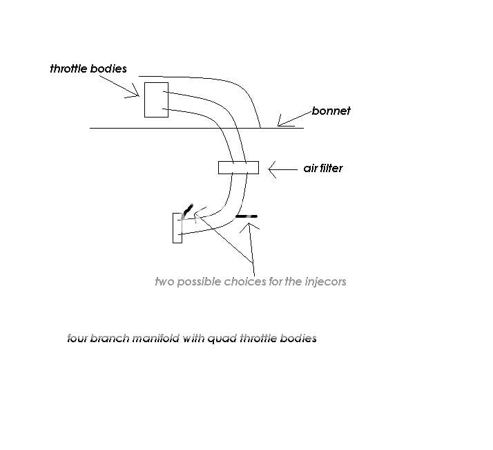

jowley Ex. Club Member Jul 13, 2009 #1 right im making a custom inlet manifold and heres 3 designs comments please
frank Club Member Jul 13, 2009 #2 if its single t/b, plenum ftw as fitted to most new cars, and ram air will be very speed dependant (loads in top gear, but sweet f/a in 1st gear ) http://www.micra.org.uk/attachment.php?attachmentid=13216&stc=1&d=1247512455 http://www.micra.org.uk/attachment.php?attachmentid=13217&stc=1&d=1247512455 Attachments inlet mani.jpg 46.2 KB · Views: 223 P22.jpg 109.2 KB · Views: 201
OP OP jowley Ex. Club Member Jul 13, 2009 #3 im going to want as much power gain too and is unsure weather a longer manifold is better than short
A Alienfish360 Awesome Dawson Jul 13, 2009 #4 Even and equal is best, but take into account your wiring, and position for accelerator cable also.
