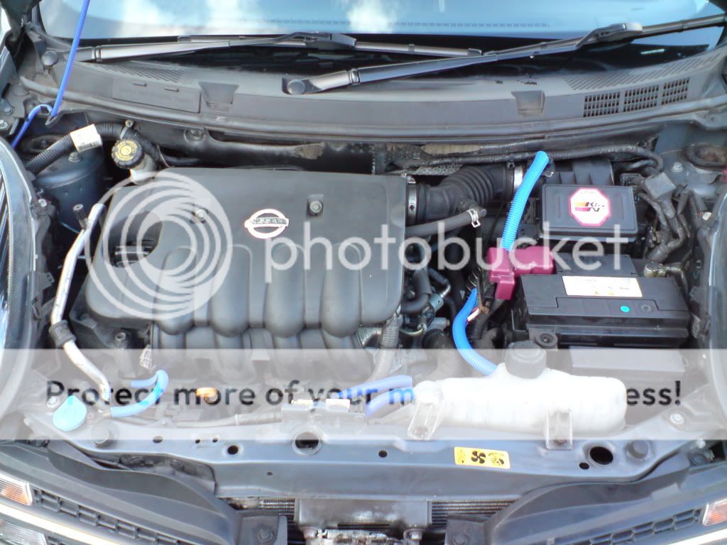

Just fitted my K&N panel filter and removed the rubbish air feed plastic piping and modified the air box to take a cold air feed pipe staright from the right fog lamp. The car seems to rev a little cleaner above 4,500rpm all the way to the red line, and it looks a little different to.
I had to jack the car up and undo the front splitter and under tray just to remove the fog lamp, poor design Nissan!! Has anyone else noticed that this is a real trap for crud, leaves etc? I suppose it was a ploy by Nissan for all the older Micra owners to take thier cars back to the dealership just to get the bulbs changed???

I used the original intake hole on the air box, but had to take the air box and battery out as the air box needed a bit of modifying to make the induction pipe fit flush around the plastic inlet. ( I had to hack saw the plastic bracket off at the bottom off the inlet hole, so I could fit a julbilee clip in place.)
I have tried to upload the pictures from photo bucket but have not been very successfull, any suggestions??
Here you go... ;)
(You need to use the IMG code in the box on the bottom left of the page, rather than a link to the page itself. :) )
Thanks for sorting the pics!
Any views on my trumpet?? I have been testing the mod'd engine through all the gears and at different revs and am 99% sure it has given a good bhp increase.
