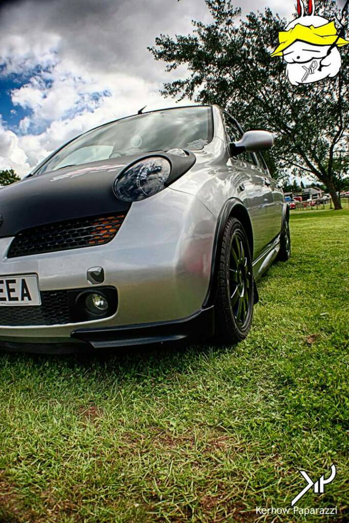

Well Chris, the K12 Sport+ is a second car/runabout, my main car is this:-
The 'mods' that I have done so far to the Micra are limited to changing the front grills and fitting the clear lenses as shown above in this thread (I have since obtained a spare front Nissan badge, which has magically turned black, and will be fitted in due course), acquiring and fitting a matching 16" alloy as a spare to get rid of the awful space saver as detailed HERE and replacing the terrible white 'Belling Cooker' heater knobs with a set of black ones as mentioned HERE .
