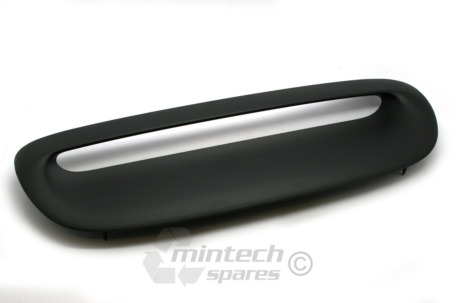

John,
I've been thinking of same issue, non restrictive flow of air to engine. With new Mini BMW MINI - NEW BONNET SCOOP R53 R52S - 2002>2008 fitted to hood and then making ducting from existing parts from scrap yards. Result, cool looking hood/bonnet with scoop intake :)
-Mika-
Nice idea Mika, though I didn't want to cut any holes in the body on my car and I can revert back to standard in a couple of minutes with the design that I have come up with for the smaller engines. There's plenty of opportunity out there for subtle modification/re-design, if you set your mind to it.:cool:
Used hood from Netherlands it's 100€ including shipping. You can even choose color...
Parts must me cheaper in the UK Mika, I got involved in repairing the K12 of a friends wife, after she ran into the back of a bus and the replacement hood/bonnet cost us about £25 and the front bumper £36, in correct colour, from breakers....The expensive bits were the aircon and water radiators :(
Often shipping from your islands of UK is more than value of part and all sellers aren't willing to ship to the Land of the Finns. Continental Europe is for me in that sense cheaper in many cases.

Don't forget that you will have to cut a wedge shaped piece off of the front of the Megan scoop to keep the alignment of the hose to the airbox elbow.........
Why i have to cut in this shape? For the flux direction? I think the flux anyway reach the elbow in the same way.. or not?
I think the feed’s edge re-direct flows Indipendently and it doesn’t matters the beginning of the rim/feed/scoop.
So you’re agreeing me?
Tell me your idea..
Tell me your idea..
If you cut it the way I have, when you line the front edge of the scoop up, parallel with the back edge of the slam panel the outlet of the scoop is then pointing directly at the out let of the elbow in the filter box, so that the flex pipe is straight with no forced bend in it, just a change in height, also the flex is kept away from the engine block ......
If you don,t cut it and fit it in exactly the same place as I have done you will not be able to close the bonnet without it hitting the scoop... You also have to determine the length of the flex AFTER fitting both the scoop and the airfiter box, with the elbow fitted in place, then you can see what the gap and alignment is, between the two spigots, and what length of flex fills it without being compressed or stretched....I trial fitted the inlet scoop several times, holding it to the slam panel with double sided sticky tape, being sure that the bonnet would close, BEFORE permanently fitting it THEN I cut and fitted the flex pipe...... You will see from the difference in two pictures above that I still had to trim a small amount from the L.H. edge of the scoop, even after permanently fixing it, as it still rubbed on the underside of the bonnet...
I'm not obligated to do this fortunately, i mean take attention to the bonnet because it's not fitted into the slam panel but in a lower and smaller subframe..then for that i'm completely in safe..
On the other side i don't have a big flat surface where i can easily fit the scoop, instead i am handcuffed for this, as you can see on my photo (#35th reply), so i need to drill on the nearest flat part of the scoop, and fit on the first flat part of the subframe..
Anyway thanks i'll sure pay attention for the final fitting..
