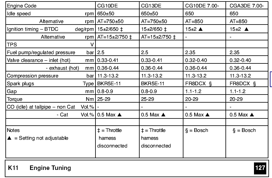

For the spark plug colour I'm pretty surprised it is green. I can not find sites explaining green is heating. But I did find sites that say it is from leaded fuel :/
Here is a chart. You should check your plugs for correct grade and correct gap. Which brand do you have there?

I'm not sure what the correct gap is for a CG engine but it might be 1.1 mm instead of the regular 0.9 mm. If someone could chime in here please?
For spark plugs, if you go to your preferred shop, they might have no NGK at stock. Just tell them you need NGK and if needed with the correct gap. Don't let them propose you a replacement, NGK copper is all you need. Cheap and easy to replace.
Besides spark plugs, the rotor is a often overseen but a cheap part that needs to be replaced for strong spark.
1.1 millimeter it is. Don't let them sell you 0.9 mm while you could adjust with a feeler gauge and if you happen to have a feeler gauge check the new spark plugs for correct gapping. And NGK it should be.
.Maarten, what is the source of this K11 Engine Tuning page 127?
I think its from service manual
Really? Is it just me not being aware brown RTV is possible with Nissan and that service manuals can have a page with the page number not in the middle? I'm curious because such a list is a good start and what would be on page 1 to 126 and further might be even more interesting to squeeze out some performance like I like to do.
