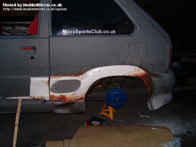

If it does get in the way of the door, could you not simply put a cut in the arch where the door opens and closes, and bolt / stick etc the kit that you've cut off onto the door! so it looks like a complete arch piece when shut, but splits into three when the door is opened!? Its hard to describe what i mean but hopefully someone can work it out!
i know what you mean and it is exactly the same as what i did with my rear 1/4 panel wide arches
edit: little piccy to demonstarte
