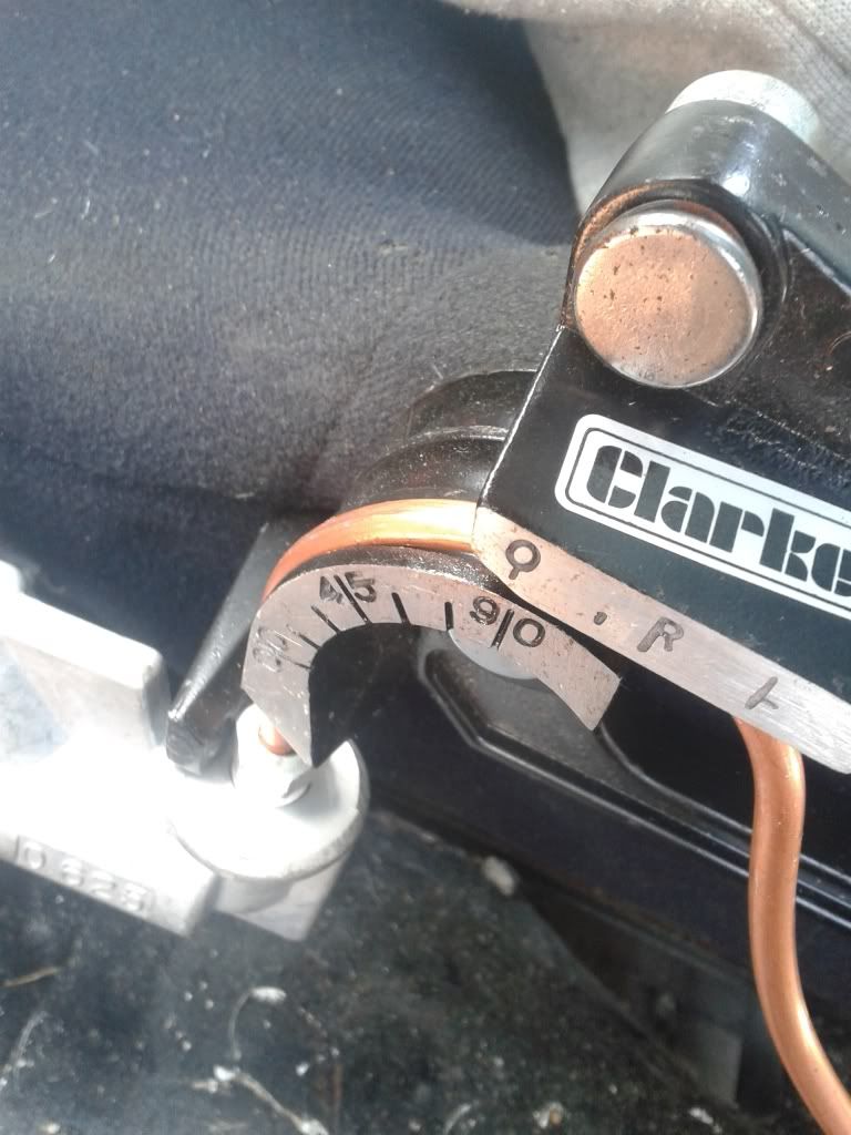

Sharp bends over a right angle use a 30mm socket. Anything less or straighter... it doesn't matter
Never bend by pushing your thumbs in the pipe and pulling with your hands (if that makes sense) as your thumbs create a pressure point in the pipe :)

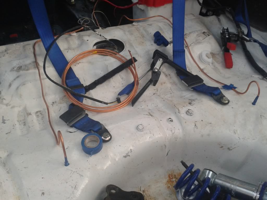

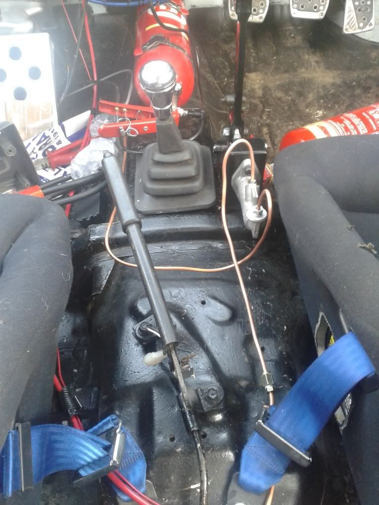

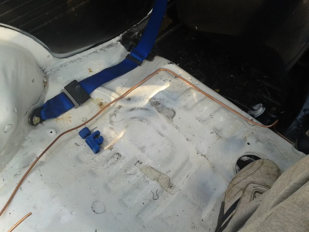

Last time we left the feed pipe hanging through the firewall.
We also left the rear pipes with hoses on left dangling

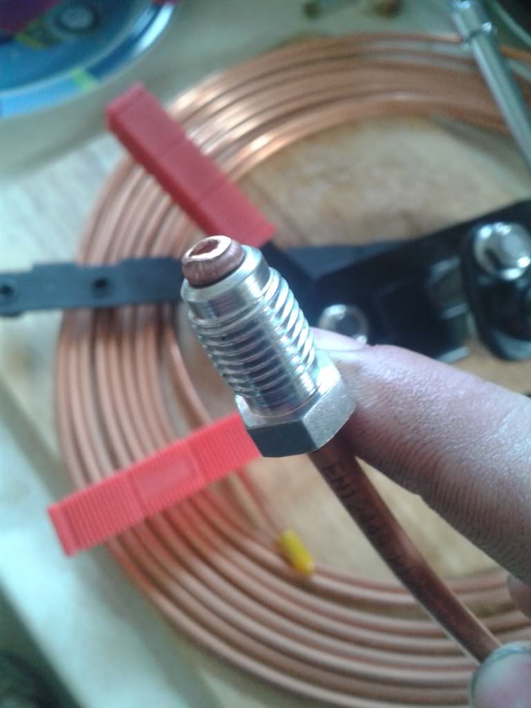

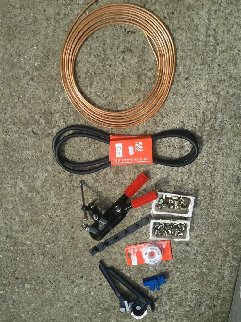

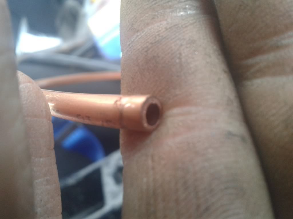

To finish the rears a small length of pipe with one male fitting on needs making with a flare bead either end

Carrying on from this

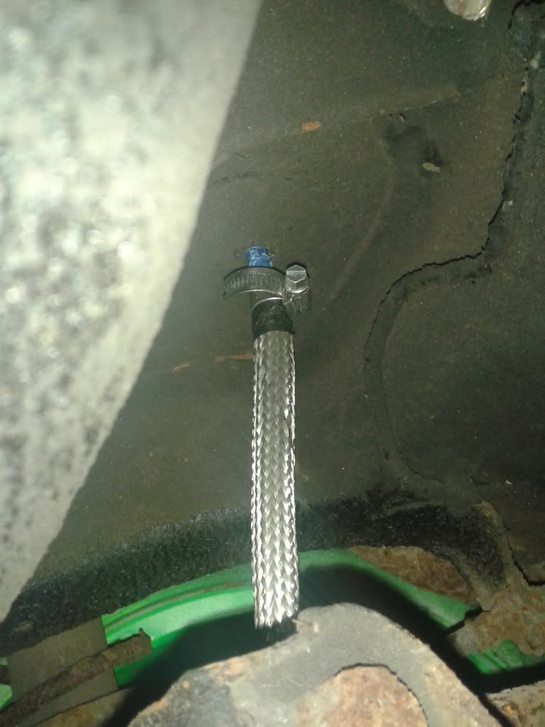

Put this in your rear cylinders/calipers
And simply connect those rear hoses. Job done on the back :)
Moving onto those front pipes...
Front pipes
Remove your original ones from your master cylinder

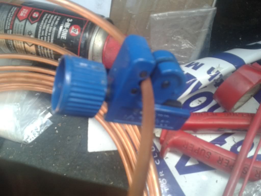

Then continue to fully remove your front pipes. Dont be scared to cut em if need be.
My engine was out at the time :)

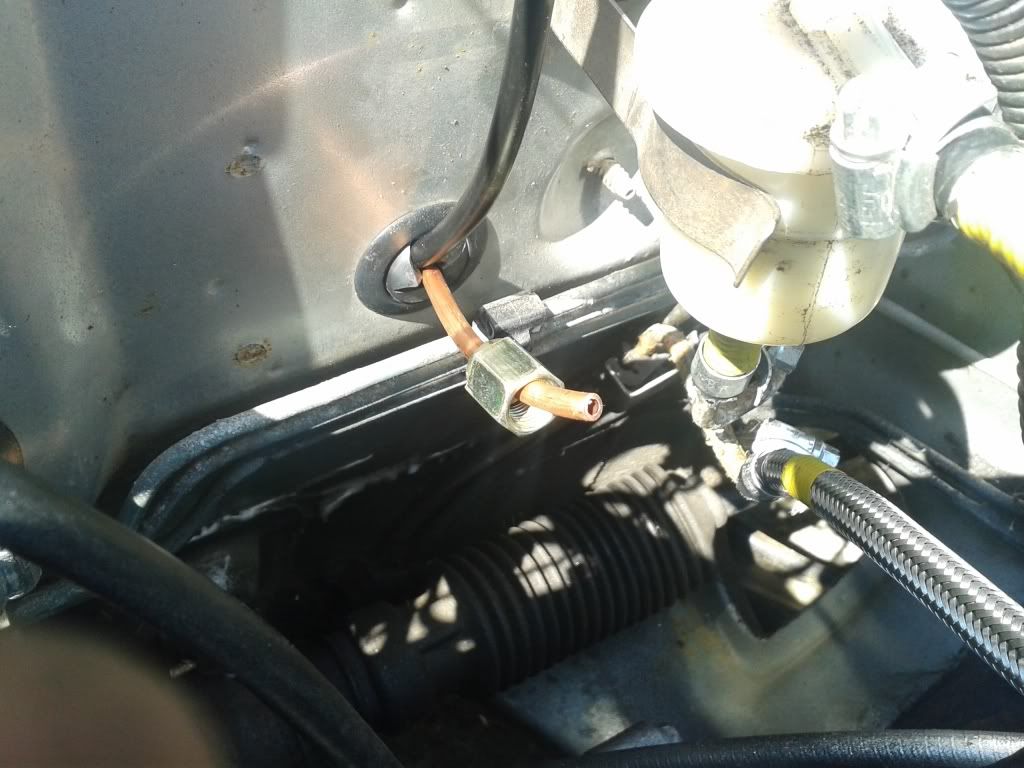

Once removed take your new pipe and feed it through the existing grommet
Proceed to bead the end (no fitting required) and bend into place

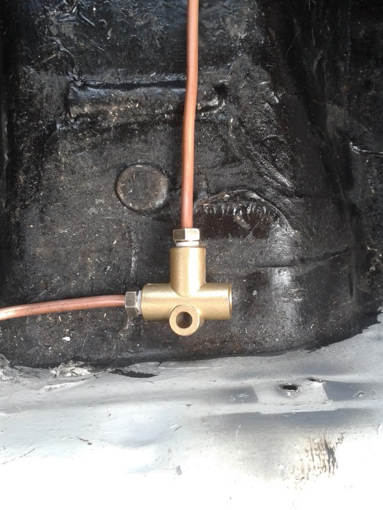

Then trace it back to a suitable place to mount you T-piece
Once you're happy cut the pipe, add a male fitting and flare the end as shown. And fit your T-piece to the end
You can see where the rear feed left off :)
Mirror this for the other side.

Mark and cut here
Proceed to add a male fitting and flare the end... and join to the T-piece :)

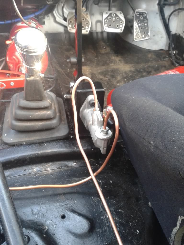

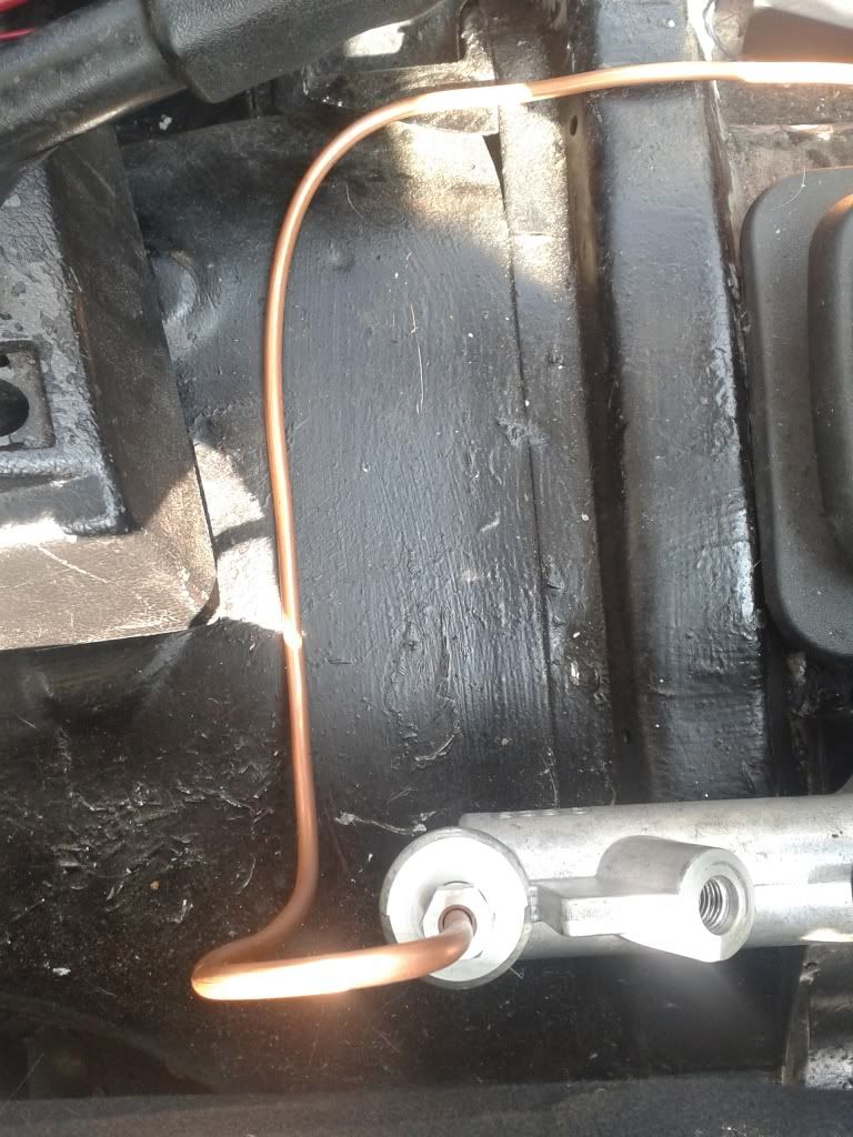

Next stage plumb the m/c in and front brakes

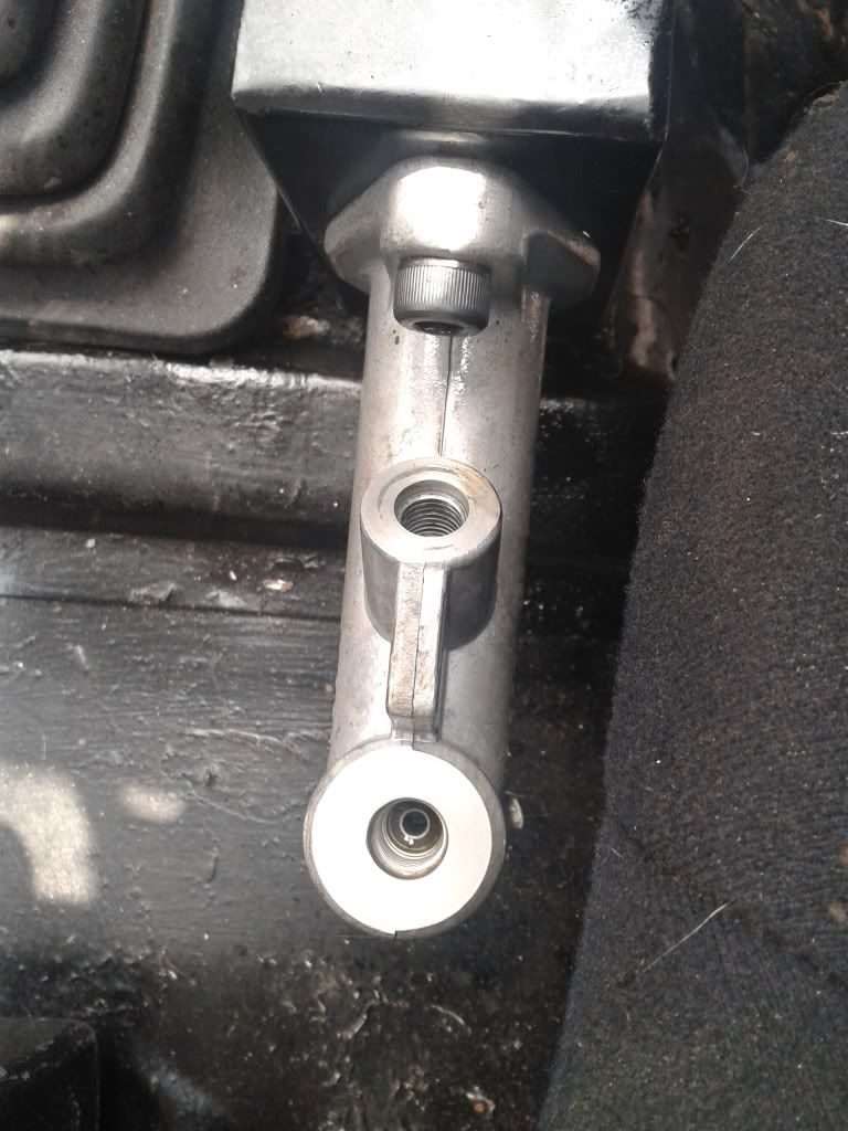

Add a male fitting... flare the end and plug into the master cylinder

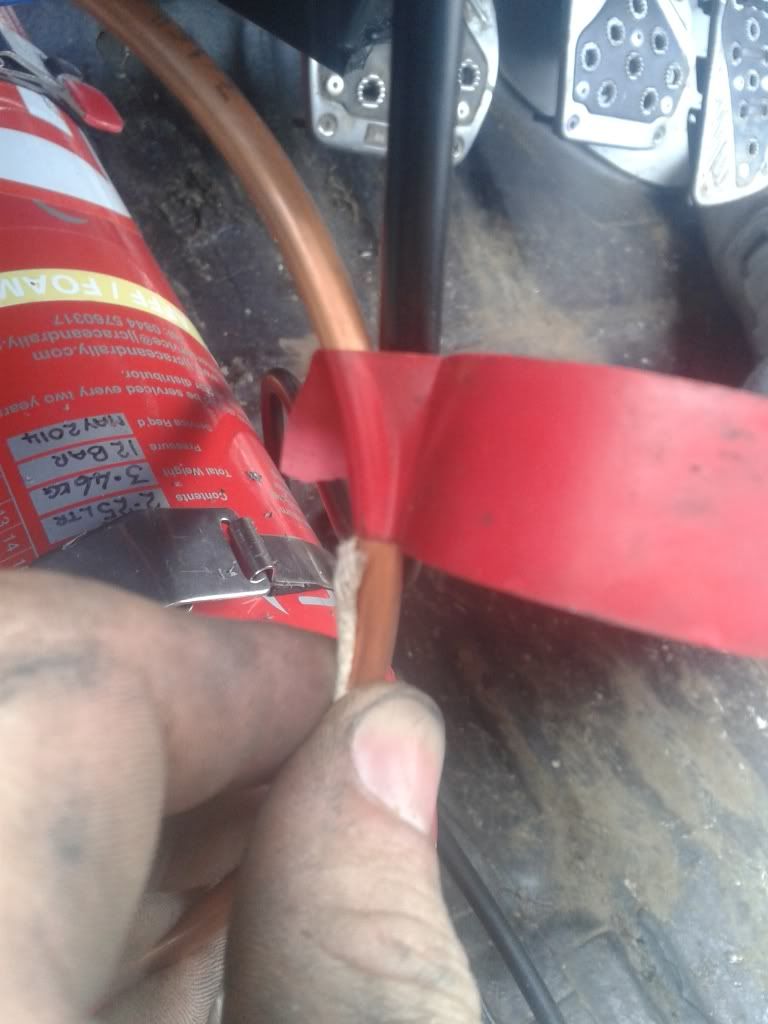

Trace this round to either your t-piece of your female fitting from the rear pipe
That's mine
Vice-versa with the second output.
