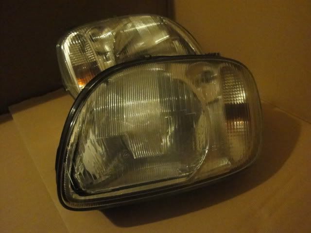

one set of nissan micra headlights
take the heatgun around the sides to heat up the glue and pull them apart, warning it gets bloody hot lol

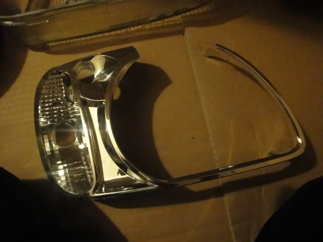

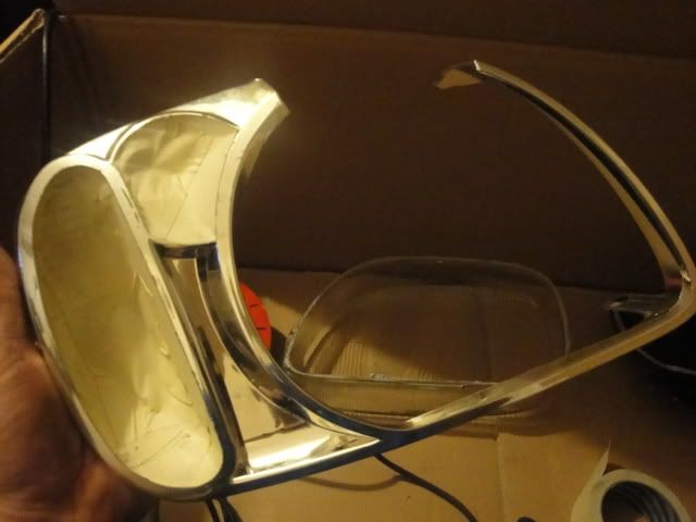

the plastic reflector part comes away just a few clips you end up with sumit like this

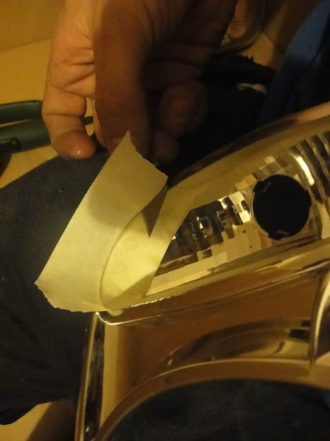

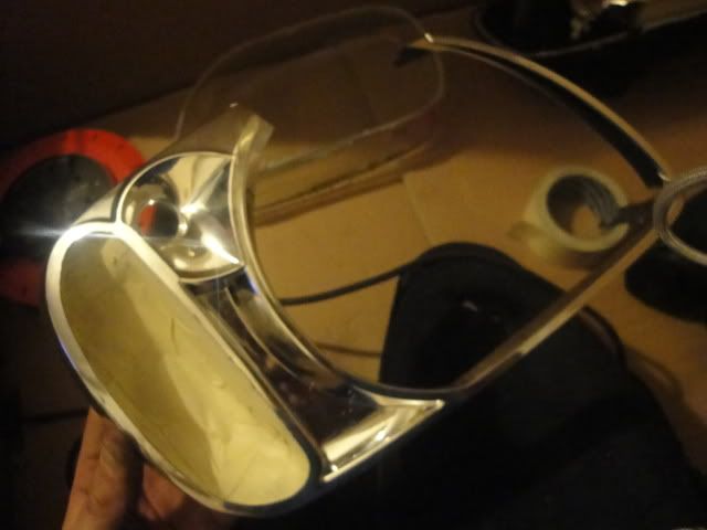

mask the inside of the reflector side light and indorcator, i used maskingtape, run a sharpe stanlyknife along the edge to trim it off
indercator done
sidelights done

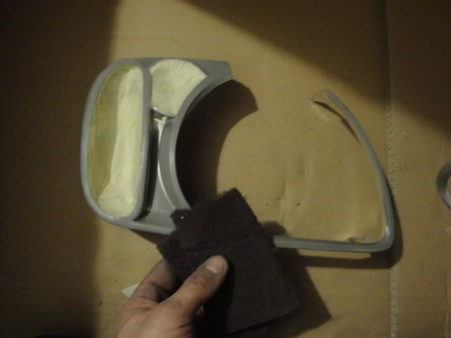

using scothbright sand the plastic to give the cover a good key

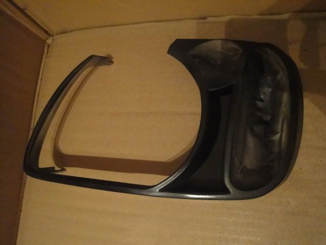

i tackraged the plastic before i primerd them i dont have a pic of the primer but heres the first coat of black

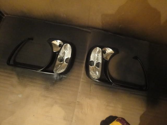

few coats later and removed the masking off

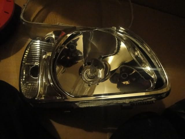

i cleand off the glue from the lights and then re silicond them up end product
