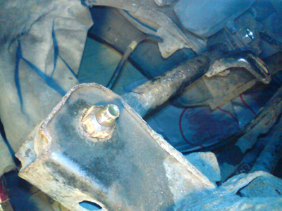

yep just replaced a seized upper arm bolt but tis the same procedure for the lower if its seized
dsc09078-jpg.28934
http://micra.org.uk/threads/pollymobiles-rebuild.35251/page-105#post-667796
