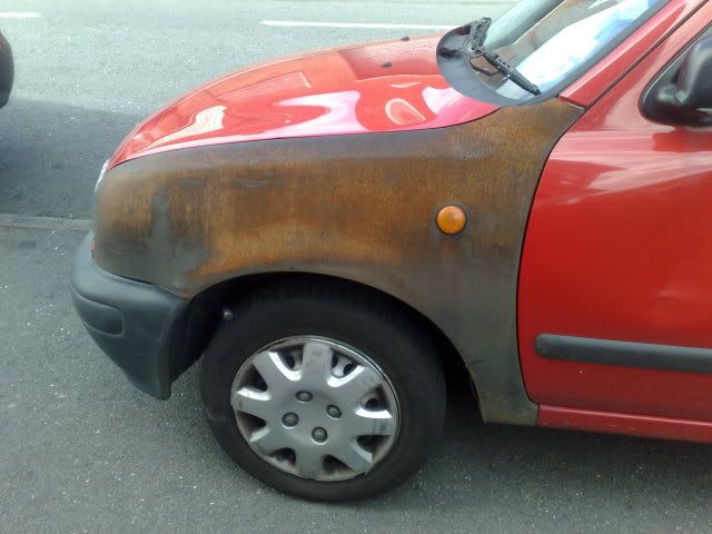

Just saw this thread and thought I'd post something up to tell you, You don't have it as bad as me.....:D

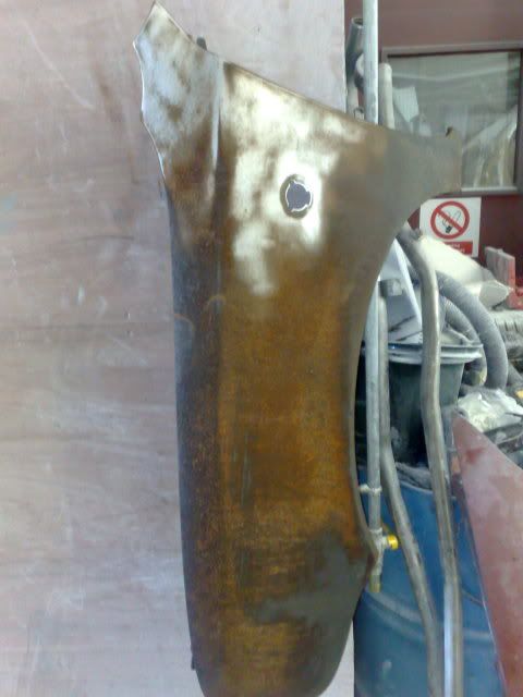

Ok as promised i have an update for you Nainy. I'll post in this thread for reference.

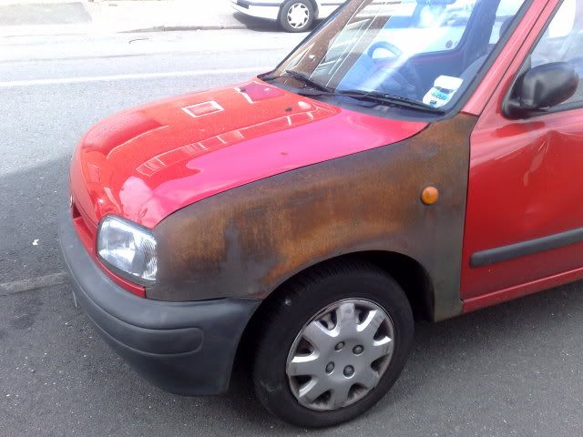

1.) Take 1x rusty Micra.
2.) Get 1x Cheef in his battle gear.
3.) You'll need a DA with a 180 Grit paper. (Or at least it's what I used).

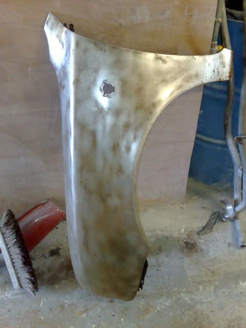

4.) Lightly rub off the rust with 180 (or higher depending on how thick it actually is!)
5.) Now you should have something like THIS:
6.) You'll need to wipe it down with some spirit (Not Vodka :D) or a clean tissue,

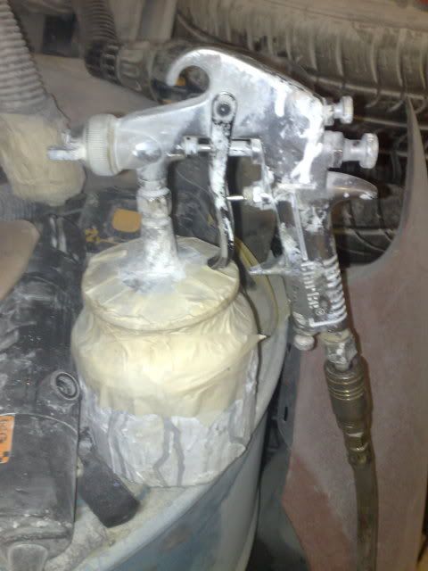

and Start to apply a thin and even layer of primer with one of these:

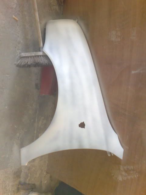

7.) Nearing completion now and it SHOULD look similar to this:

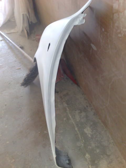

8.) Finally you should wait for your first light coat of primer to settle and dry THEN lay on some more evenly. Making sure not to get runs in it. Also you'll want to primer the bits that wont really see daylight, like the inside flanges and under chassis fitting as well as behind the door section.
Like so:
I will get more as I do more. Just ask. :)
