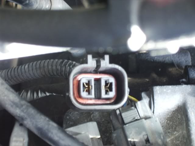

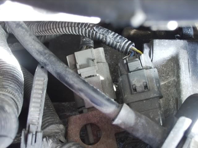

This two connectors are the ones you need to "work":
To bypass the CVT inhibitor, its just a matter of joining the two wires on this connector, make sure its thick enough:

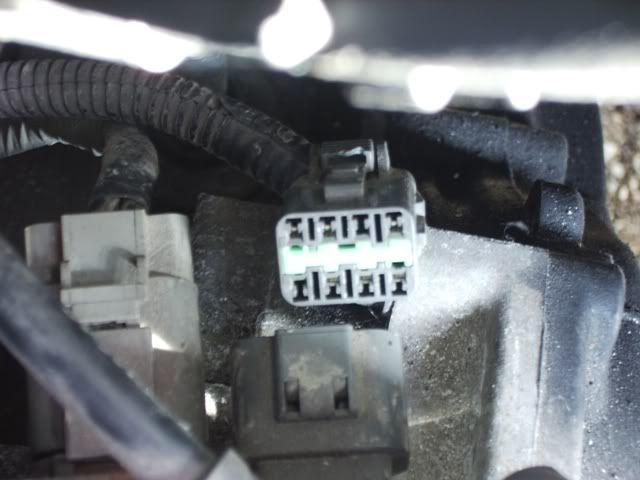

To enable the reverse/neutral switches, use this connector:

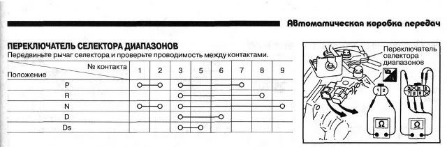

Use this diagram to make the right connections:
That wiring diagram is from the gearbox connector, on my pic is, front left to right on the upper line to lower line:
6 - D
5 - Ds
X
3 - Positive
X
9 - N
8 - R
7 - P
So, you just need to join the pin #3 to both switches on the manual gearbox and join each of the other wires to pin #8 and pin #9 on the auto loom, in correct order.
6 - D
5 - Ds
X
3 - Positive
X
9 - N
8 - R
7 - P
