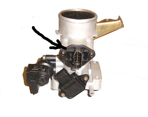

someone with facelift can answer that. alternative without removing the MAF module is to spray carb/brake cleaner through the MAF wire to flush dirt off whilst holding throttle plate wide open, let fully dry before use
