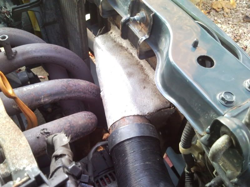

Can't see lack of airflow being the problem. Here are a couple of pics of my setup.
