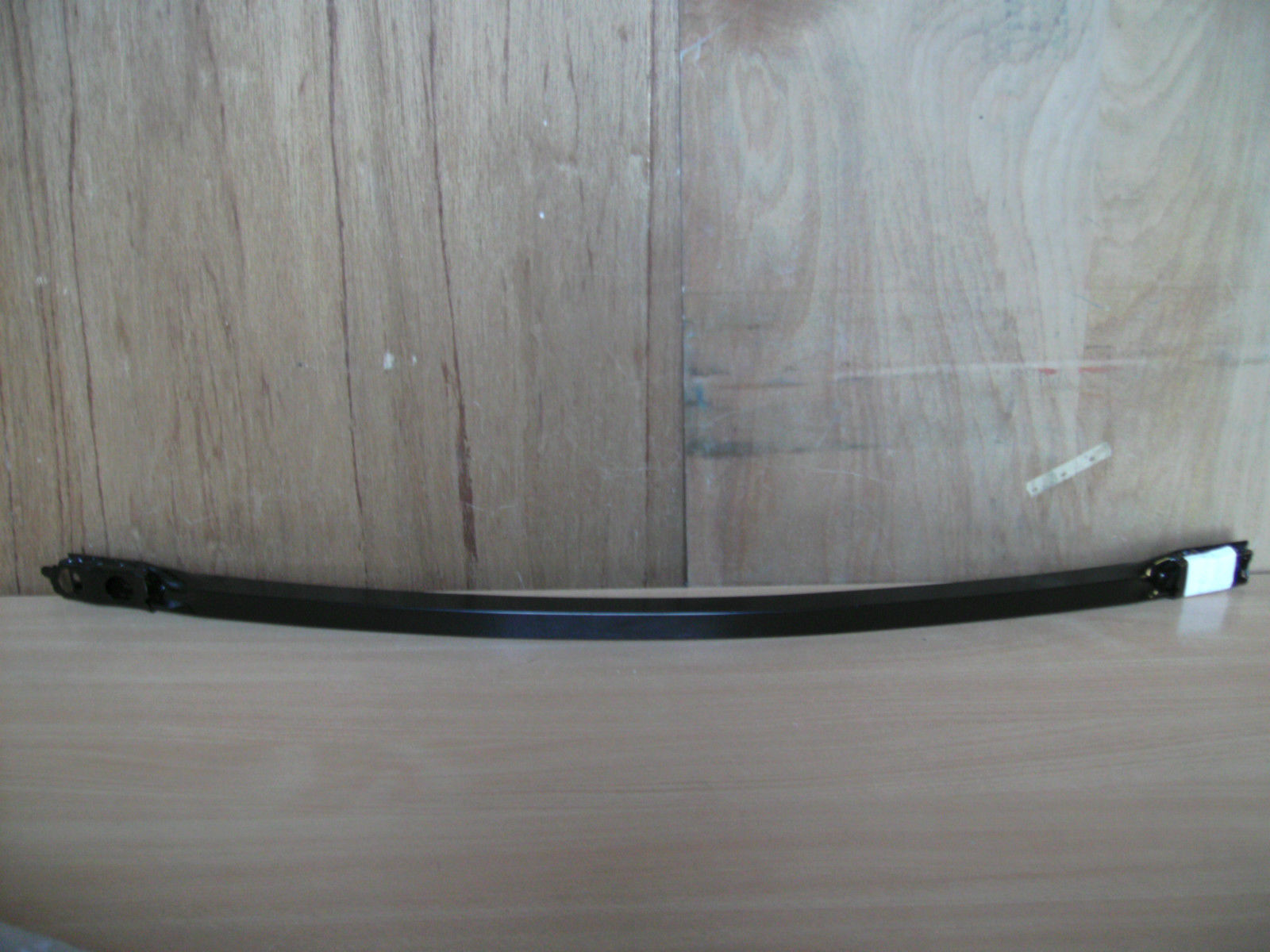

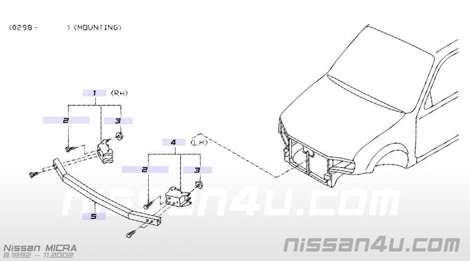

Well my K12 has no plastic under tray, so probably not on the K11 either and this appears to be the only bumper reinforcement fitted to the K11....
Which appears to be fitted on the 2000 model, but not on 2001 or 2002 cars......

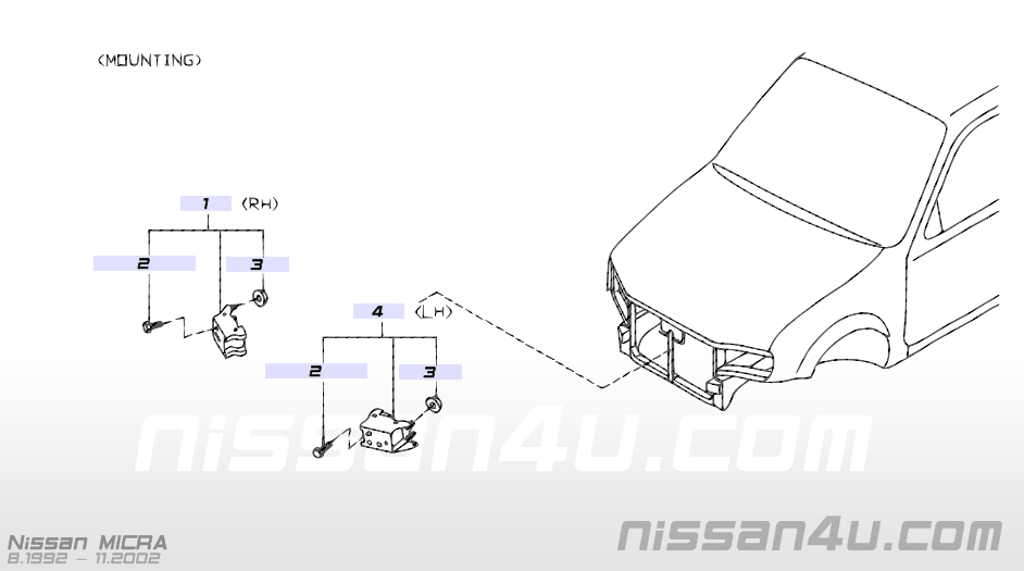

It looks like the 2001/2002 cars have the stiffening member integral in the bumper......
Below is the mounting details for the 2001/2 cars.
from what i remember from removing my bumper to fit my Impul one, onto my 51 plate k11. There was just the two mounting points and that was it

So yours is early 2000 car, manufactured prior to August?...The changeover to integral bumper reinforcement from the separate bar seems to have occurred in August 2000 and kept with the K11's till the K12's started to be manufactured in November 2002. Likewise the separate reinforcement bar only appeared on cars manufactured from February 1998, so your 1998, without one, car would appear to have been manufacture before February, probably manufactured late 1997 and first registered in 1998..........
