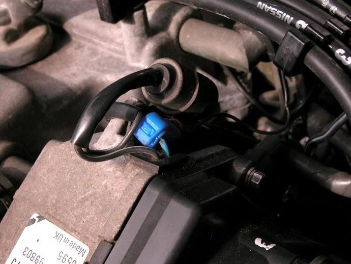

i've connected the positive switched and ground wires, as well at tapped off the blue wire on the dizzy and run it to the green wire on the tach...

i can only then assume that the OTHER red and black wires (coming from lower on the unit) are for the tacho mechanism itself, and the green wire IS the signal wire...
the blue wire on top of the dizzy is definately the right one to tap into yes?
cause if so, its all wired up fine... just won't work

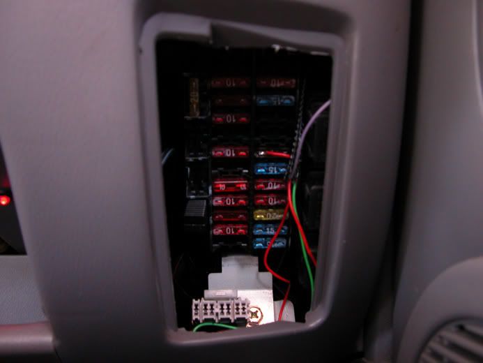

What other set? Red and black are +12v and ground respectively and green will be signal. Orange goes to your parkers, but don't bother with it.
This is some pics I took of my install. I piggybacked onto a spare fuse I had and an unused fuse point that put out the correct voltage.
