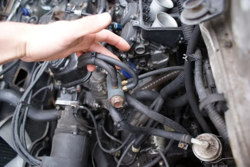

Heres the manifold block I made, 4 pipes, 1 to each cylinder, 1 small pipe to the vac advanced and then behind my hand, the large pipe to the brake servo
yours probably act as a balance pipe at idle too eh ryan (if the butterflys are,nt matched perfectly open all the same, but i think as long as there is a small reservoir/log the pulses will only be slight (like with an air compressor that you spray with)
Dont know tbh haha. Just thought it would be the easiest way to connect 4 vac pipes to 2 pipes of different sizes.

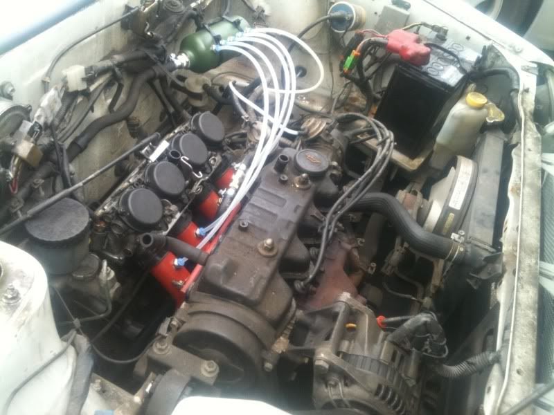

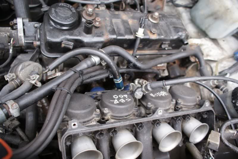

right, its all in, fired up first time no problem(Y)
quite proud of myself really:p
il state this again before i get ripped, I HAVE NO KNOWLEDGE OFF ENGINES lol but once i start it up it will just keep on revving till it sounds like itll go pop, unless i keep the choke pulled constantly!! is it ok to drive like this? is there somthing else i need to do?
you may need filters to get it to drive properly pork, or try a strip of carpet tape over the bellmouths/faces and pierce a hole for each carb (4 x 30mm maybe ? )
looking sweet mate (Y) is you accelerator cable to tight? looks to have a bit of a sharp angle at the carb end. might be just the pic?
If these are cbr600 carbs there should be a remote idle adjustment, make sure thats turned down as it sounds like the the idle screw is holding the butterflys way too open. Opening the choke means that your flooding the engine and the rev's drop from it. (if im reading what youve put correctly.) can you get a video of it?
