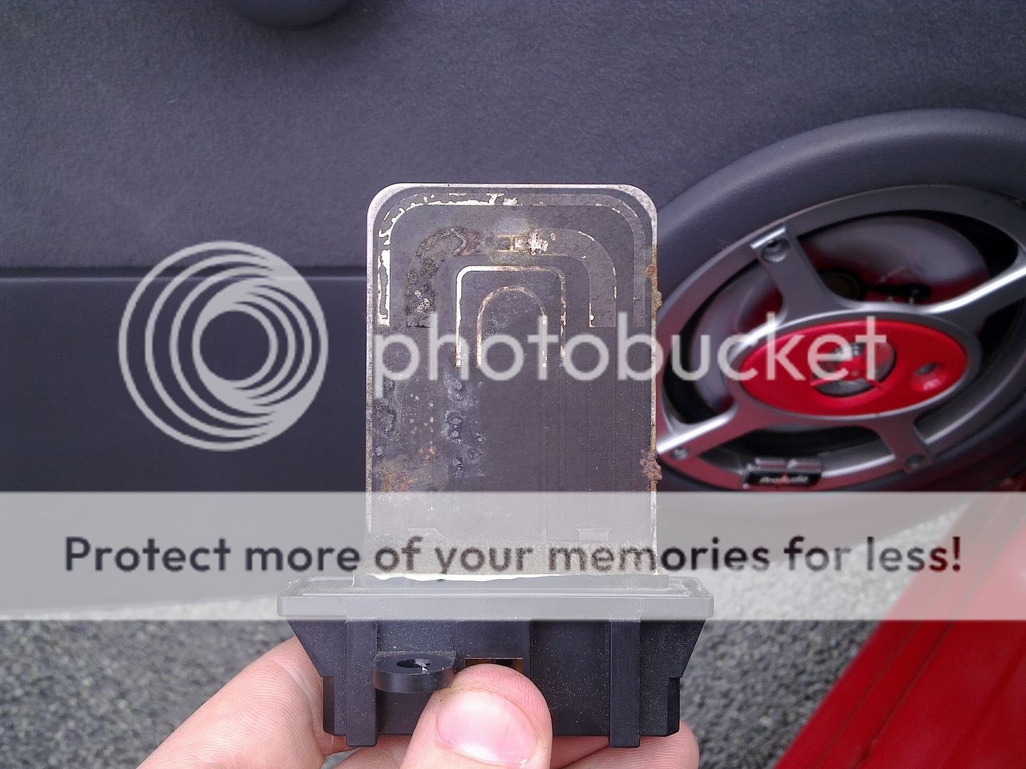

Now, my heater card is clearly damaged which would explain why my heater fan works on setting '1', '3' and '4', but not '2'.
Here is a picture of it:
[/URL] Uploaded with ImageShack.us[/IMG]
Can it be repaired and if so is it just the burnt bit that needs soldering or anywhere else? What is the burnt bit and what was it?
Stu
hey stu :p ive had this same problem with the blowers and its extremly common for these cards to become coroded yours is in preety good nick compared to the state of mine lmao (piccy below) its advised to get some abrasive paper just clean away the old ganky bit of the connection and then just get one of them curcuit board pens that fill it with a metal sort of resin thatll fix the card and its cheaper than buyin a new one :p
EDIT: oh and dont forget to put ur card back in before u try ur blowers XD
