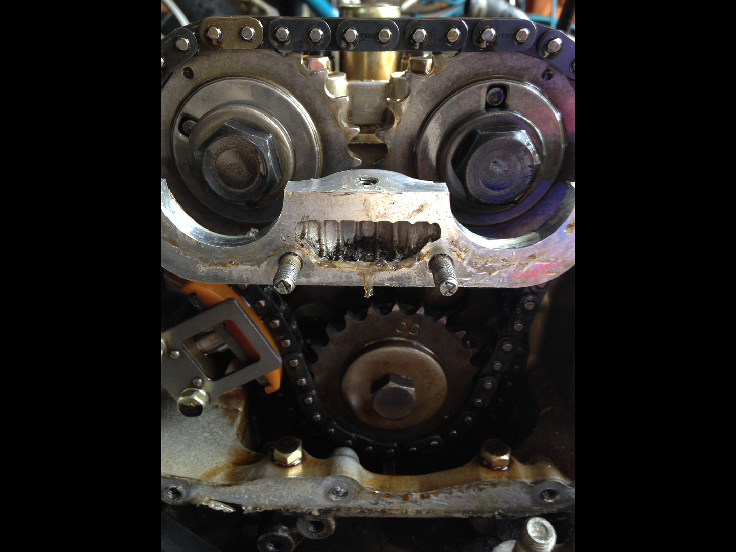

I would pop the side cover off and check the upper chain tensioner whilst you have it apart.
Doesn't look like the upper chain is tensioned

the chain should be solid without any flex (like yours)
Check the tensioner, it should press tight against the chain

Thanks for the pic I can see it :) Your chain look nice and tight. how much are the tensioners to buy/ where can I get one if mines goosed.

I took the lids off guys, top tensioner looks okay. While I had it off I gave the bottom chain a wobble and it seems to be really loose but from what I could see also the tensioner was up against it. Does it sound to use guys like the chains are goosed?

the lower tensioner is just sprung loaded.
did you test the upper tensioner as I wrote?
So will the bottom one be able the wobble?
Yeah u think I done want you said right and the tensioner seems to sit Nicely on top chain.
yea little bit.
turn the crank by hand 1 turn then recheck if the top chains snug. is the tensioner shoe loose that you can you nudge it in/out few mm?
if you turn the crank backwards the chains will slacken sean, but as long as the chains are tight when the engine is turned off they,re fine
the bottom chain seems to be pretty slack. top chain as you can see from vid can move up and down but the top tensioner looks to be working @frank you think I should just run it?
Bottom one doesn't seem to be tight and top one the tensioner is still up against the chain but you can still move it as you can see from vid
if they,re tight when you turn the engine off then the tensioners are doing their job sean, but if they are slack then the tensioners are fully out and the chain/chains are shagged
