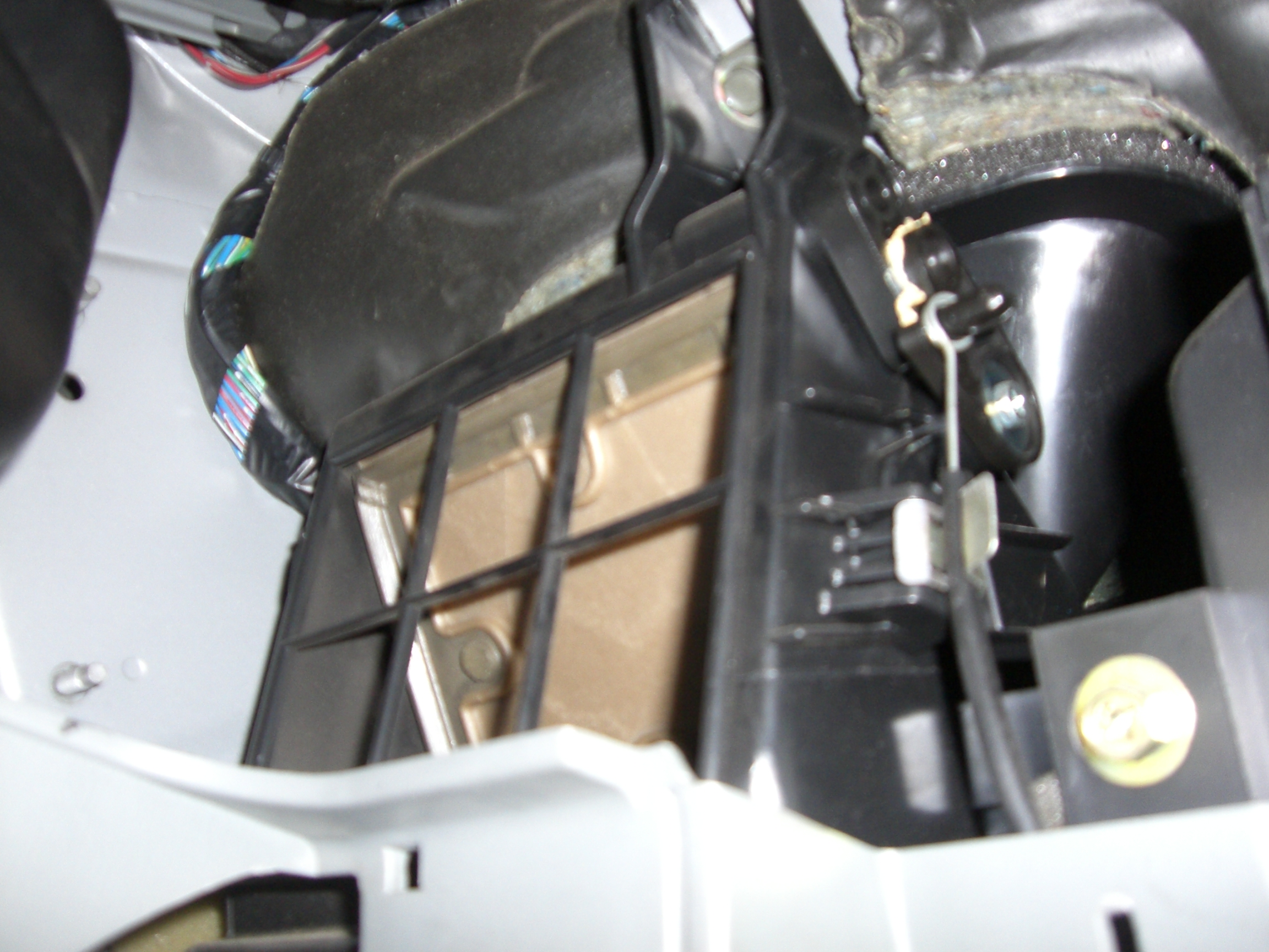

Right here is a picture where the air is coming out from and is this normal ?
The brown bit is where the car is coming from. And the volume of air does decrease and increase with the switch on dash. But the air doesn't seem to get directed with the switch .....
Any ideaS?
Ming
Right that cable is not doing anything. As when i move the latch the cable operates the brown bit moves.

Thanks everyone, stripped the dash everything is working as normal. Then went to look at the filter, it was caked with crap!!!!!!
On sat, so couldn't get a replacement, so i just removed all the wool and left the mesh as a temp solution. The air coming out now is amazing!
Looking at it, you might able to remove the filter just by removing the compartment box!
Anyway couldn't do it with you guys and the pic helped alot!
