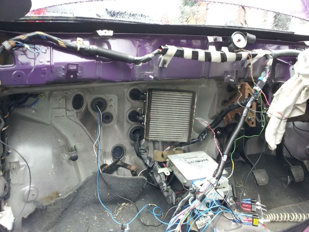

Removed the heater matrix today. Can I simply block the two water pipes that lead to/from it? Will I stop the coolant from circulating properly if I block them? Is it preferable to connect them together?

the heater matrix circuit runs parallel to the engines coolant return pipe so blocking it won't disturb engine cooling.
with matrix removed (if ya don't mind replacing the coolant return pipe o-ring) you could also cap off or crimp in vice the metal ports on the coolant return pipe that the heater rubber pipes goto (eliminates some useless hoses n weight)
while ur there may as well remove the TB coolant lines & crimp up their ports in the return pipe (keeps TB cooler) and remove the TB waxstat mechanism (prevent TB stuck in fast idle since the coolant lines disconnected)

When i ditched my heater matrix i used 22mm copper and 2 jubilees and cut the 2 coolant pipes and linked them together. Worked really well, as for 12v heaters theyre useless! My plastic windows froze inside and out and had to sit for ages to defrost which was impossible during minus temps. Also steaming up was a big issue

Today I struggled to temporarily block the water hoses, I ended up clamping a wheel nut in there and blocking that with a bolt. I connected up the instrument panel to start the engine but nothing! The 12v would appear to be totaly flat, at least I hope that's it, not even a light on. :( I'll take another look tommorow. I can't for the life of me think why though?!!:confused:

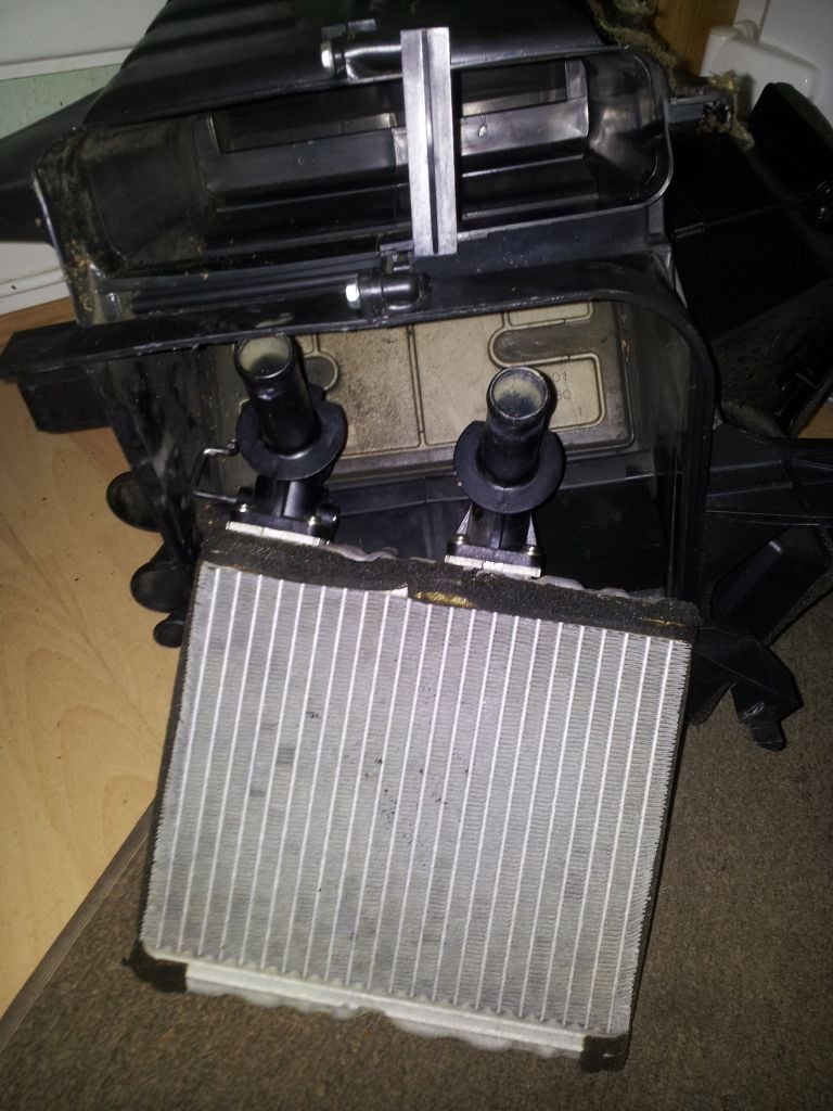

The heater matrix weighs in at 1.1kg full of water. Plan F (it) says it could go back in and the pc fans encouraged to pull air through it or at least from it's general direction.

Here is the progress so far on the heater demister replacement.

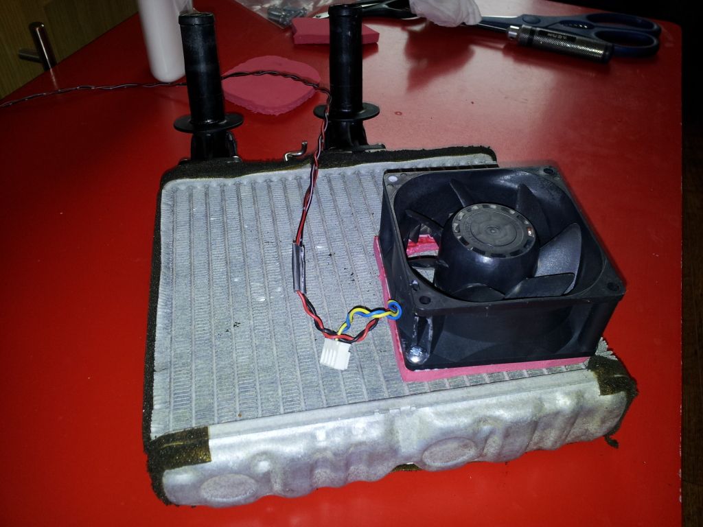

Coolant filled matrix element makes it back into use with high volume 80mm cpu fan screwed to it. Gasket is to prevent vibration noises.
Here it is back in the car. The fan is set to blow through it. There isn't a feeling of much breeze there so it wont p*ss you off in the passenger seat but I think it will make a difference.

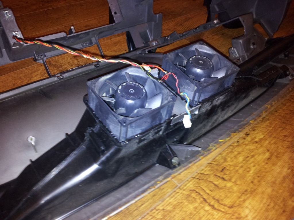

And now for the Pièce de résistance. Two more 80mm cpu fans mounted in the bottom of the windscreen ducting. Together these babys really shift some air! I have been planning to install some ducting but because the whole space behind the dash will fill with warmed air it might turn out to be unnescessary.

The cars interior doesn't heat up much so I am currently experimenting with different locations for the fan you see screwed to the heater matrix. It spent a little while on the bulkhead behind the rad but the air still doesn't get out into the car. Now it's in the (absent) glovebox region pointing forward onto the rad, no results yet.

Still faffing about with it tbh. I don't seem able to shift enough air over the matrix and into the cabin to build up any worthwhile cabin temps. I reckon the heat I release from the matrix disappears up into the screen ducts which work quite well considering there is no 'fresh in' ducting.
I think trapping the matrix in a light plastic box with a fan, possibly two, mounted in its lid? is my next option. This way the box will pressurise and I can run small (vacuum cleaner pipe?) ducts away into the cabin footwells instead of leaving the warm air behind the dash. I'm thinking biscuit box or similar.
