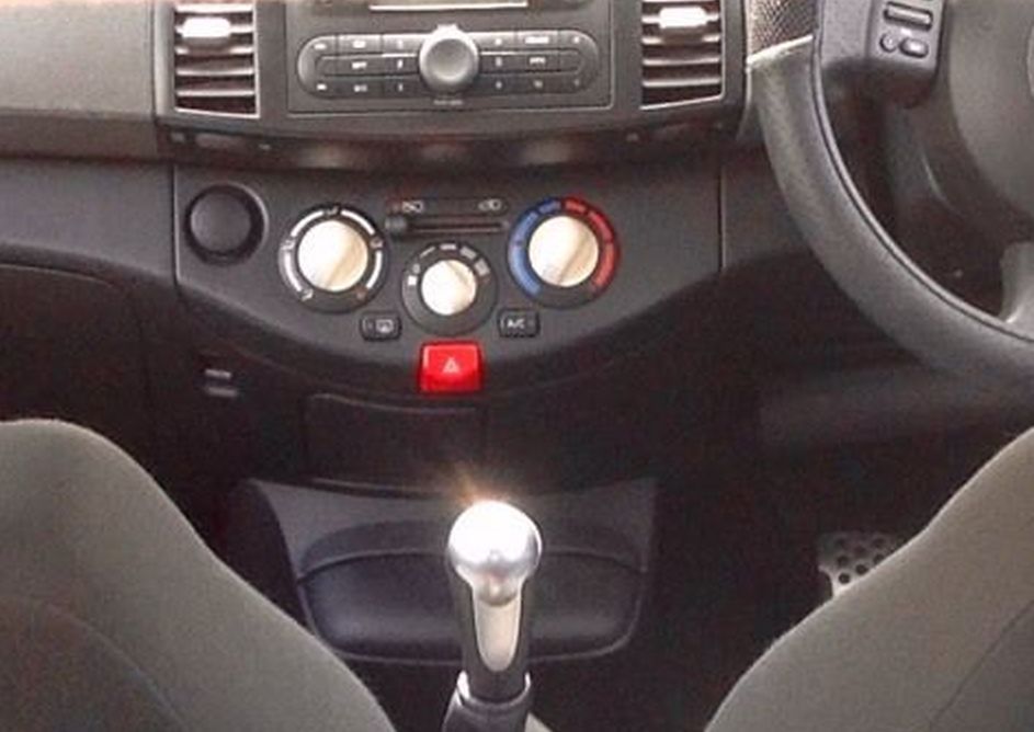

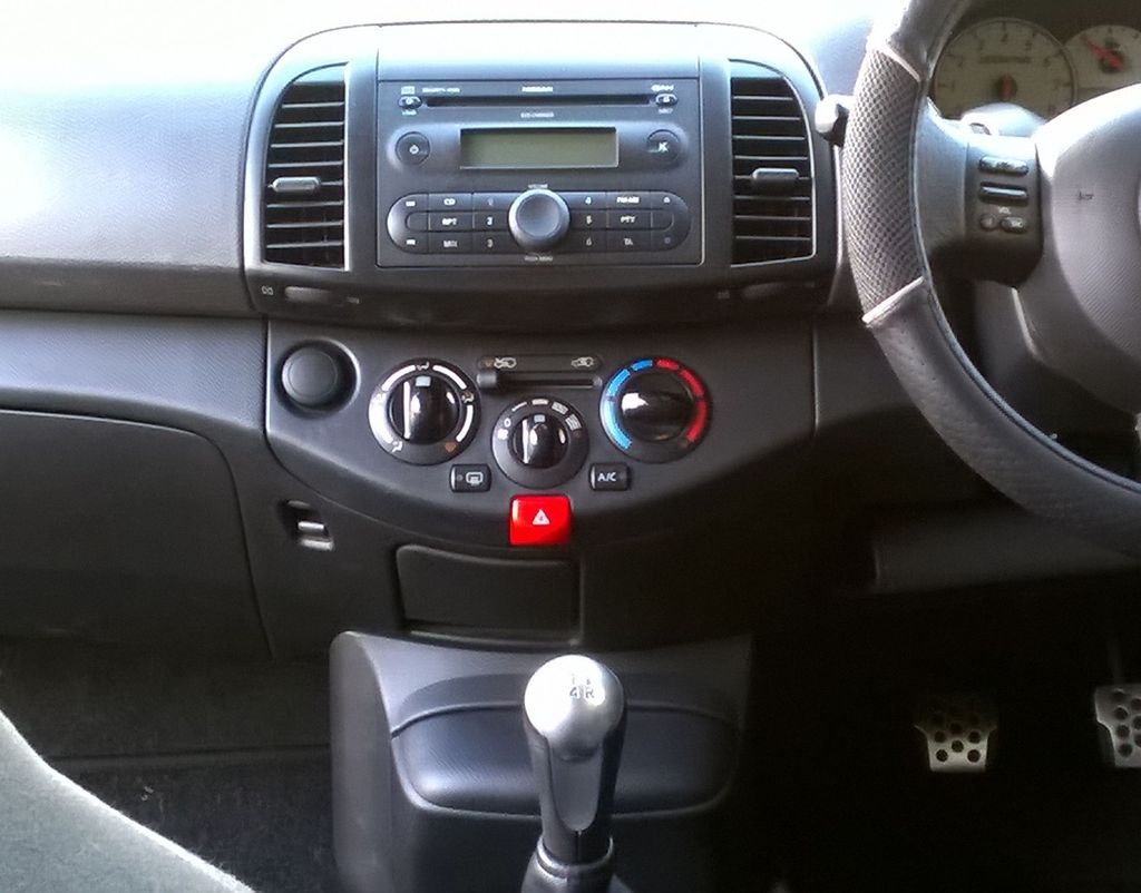

Anyone else on here positively hate the white 'Belling Cooker' heater control knobs?
I think it must be a 'Marmite' thing, but I really think they look awful.
Found this on ebay, for the princely sum of £9.99 including carriage
Now that's better
(the knobs just pull off and can be changed over) :0)

@John_D What did you search for to get these black knobs?
Sent from my SM-G935F using Micra Sports Club mobile app
You need to buy the whole heater control panel with the dials on. Plenty on eBay. Just pop them out on both and swap them over. You could then try selling the spares

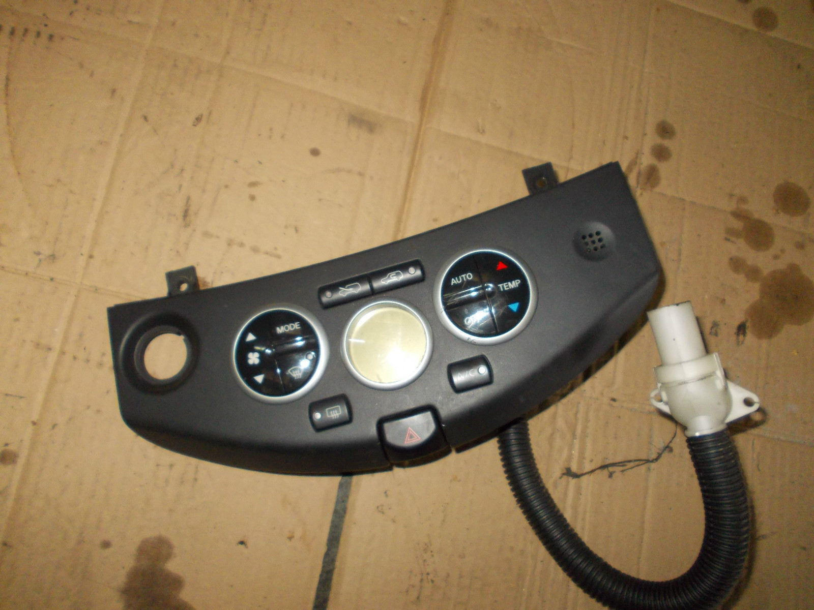

Might as well add this to this thread, this is the latest encarnation of my heater control panel, thanks to the front panel and control knobs from a Nissan Note.....
Well that was an 'interesting conversion'.........
65387
All in place and everything works......
BUT definitely NOT a straight swap over on a 2006 K12:mad:

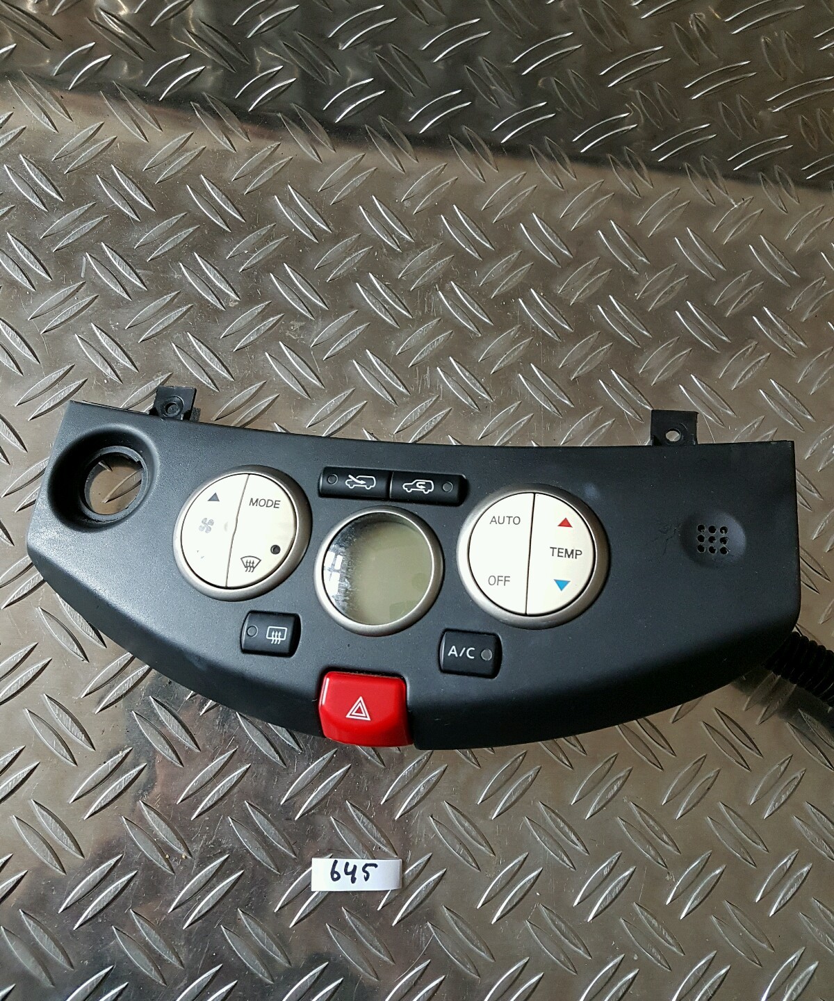

I was comparing the 'Note' heater control, front panel donor unit, with the spare 'Micra' one I bought about 3 years ago, for the black knobs, and everything was identical and swapped over on the bench, however when I stripped down the dash on the car to fit the panel all was NOT the same:(. It would appear that Nissan changed the units on the Micra K12, very subtly, sometime after 2006 when they fitted ones with black knobs to the K12 (they probably 'standardised' and fitted the same units as the Note ones) so my replacement is either from a very late K12 or a Note.
I now understand the comments previously posted about the A/C and heated rear screen buttons being too long to fit the Note heater control front panel on to the Micra heater control unit.
65389
As a comparison, the Micra one is the top one.
The profile is also different, the Micra buttons having square flanges...
I decided that if I altered the profile of the Micra buttons to the rounded form, so that they would slide in the Note front panel, top one standard, lower one modified (craft knife and file)........
65390
then 'all' I would need to do would be to shorten the button housings in the Note panel to the same length as the Micra ones....
65391
Again junior hacksaw, craft knife and file, the one on the right is modified, with the modified Micra button fitted, and on the left unmodified, with Note button fitted....
These are the bits I cut off of the panel....
65392
So there you have it, it is possible if you really try:cool:
edit:- it would appear that 2007-2010 Micra K12's with black heater control knobs as standard would be a simple straight swap over with the Note panel and knobs as shown above, no modification needed to the front panel and A/C and heated rear screen buttons.
So 2003-2006/7 modifications as shown above required, 2007-2010 straight swap over of panel and knobs:cool:
