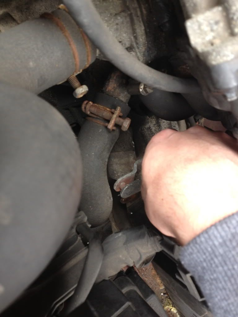

Found it today. Unhooked itself and was dangling down. Don't really need to remove the battery, was quite easy to reach. Y
Yeah the rivet didn't break although it does seem slightly dodgy. The cables broke inside at the the other of the cable.
All fixed :). Set me back £50. £30 for the cable £20 for the guy to fit it (down at my uni address, we don't even have a spanner here).
