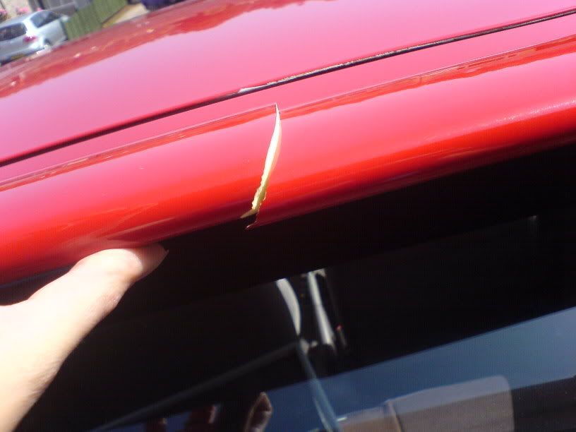

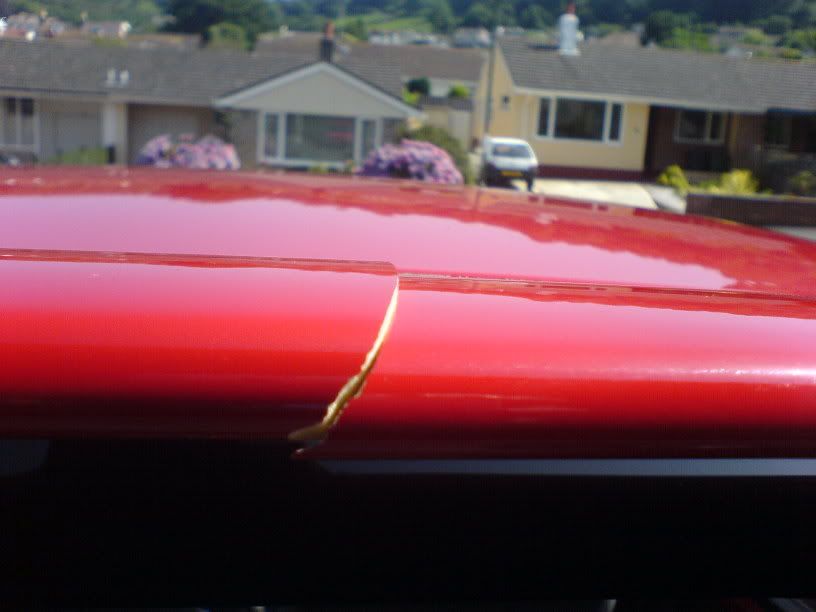

My spolier is knackered. Yes, I know I should have washed it myself, just wish I'd used the jet wash rather than the lazy option. Think the hot weather melted the glue in the middle, and the brush lifted it off. I've filled in a claim form, but don't hold out much hope. Do you guys reckon it's fixable? If so, DIY job or body shop??

Fixable, I've fixed worser spolers with fibreglass.
I'd angle off the crack edges, so when it's ready to be glassed it's a V shape, this'll add strength to the repair.

Well, it's off and ready to be fixed. :) It was stuck on with magnets and gripfill ffs!!! o_O I'm surprised it stayed on as long as it did!
