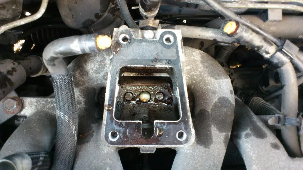

Does the inlet manifold look ok here, seems a bit mucky... Should I be cleaning it and how? Also, what can I clean the gasket with, petrol?

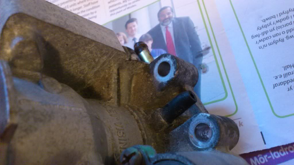

Also uncovered this hose that isn't attached to anything? Should it be connected up to anything or is it just a breather hose that clips in somewhere?

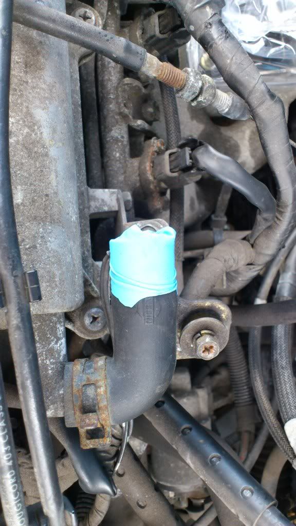

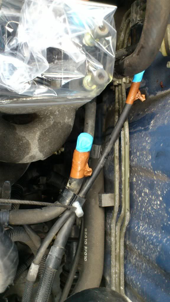

Just a tip to end with... Any open hoses you can cover with the finger of a rubber glove... Sit on nice and snug! For the coolant hoses I've plugged them with a bolt then taped the finger on over the top...

Just pull that bit of vacuum hose off oddball, and thats a breather pipe for the gearbox ( not important)

1. light coat of oil in the inlet mani is normal. it's cos the crankcase oil vapours gets sucked through the pcv valve, into the inlet mani behind the TB and burnt in the engine whenever the throttles closed and the oil vapour condenses on the cooler manifold walls.
the TB gasket you can clean with anything such as a rag, wd40, carb/brake cleaner etc
2. that u-bend pipe is basically the gearbox case breather pipe, tis normal

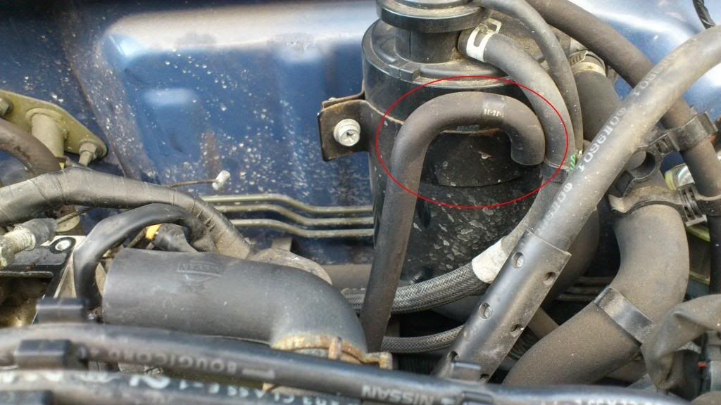

3. that thin hose bit behind the TB has broken off. at the top of the black carbon canistor you'll see a thick tube and a thinner vacuum tube. the thinner vac tube goes from the canistors diaphram port to the thin port at the back of the TB thats broken off.
what happens is when the throttles closed, the inlet vacuum through this pipe causes the canistors diaphram to open and the collected fuel tank vapours are vented into the inlet mani to be burnt
