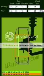

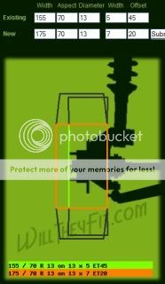

I've done some comparisons with willtheyfit.com so you can see the difference to standard and also other options, what do you guys think is the cheapest/most common good looking tyre size on a 7J with a bit of stretch? By the way, fronts had a little poke (still legal though i think) when trial fitting but didnt fit over hubs properly (hence the need for enlarging the centre bore) so may be even better when they fit & sit flush? Also plan on more drop when these wheels are finally on but i dont want them to look too small, wanting minimum arch gap or even a bit of tuck/flush without going dangerously low (i'll only be shortening my already -60mm springs).

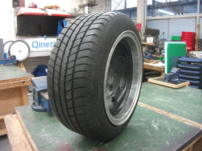

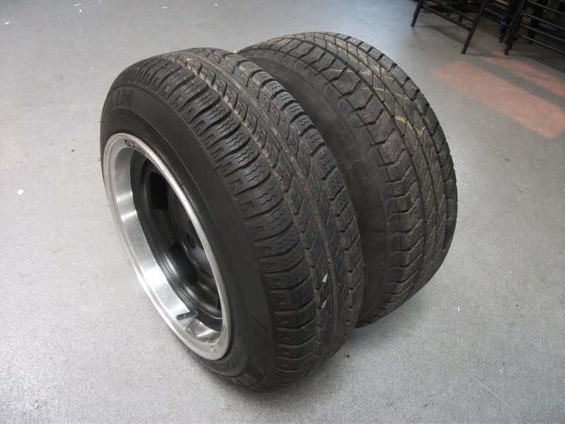

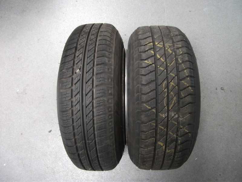

155/70 on a 7" to the left.

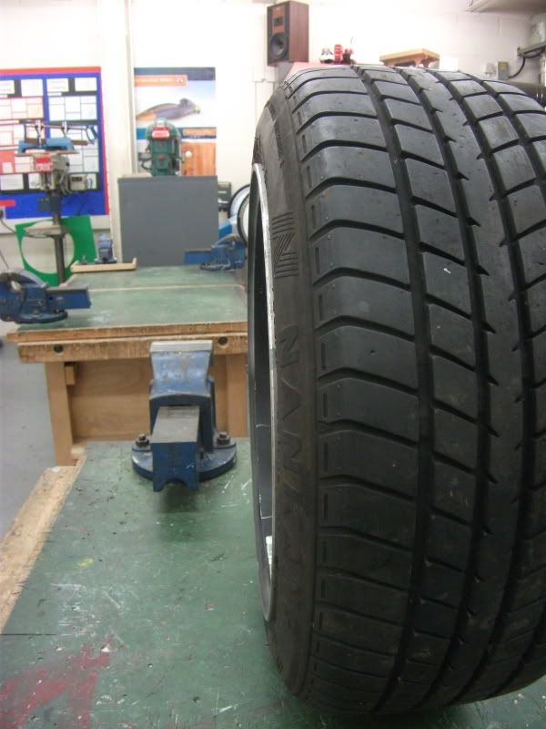

Thats a 175/60 on an 8" next to it.

Just answered my own question looking at your WTF's. +20, wow thats more than I expected, you might even need to space the rears slightly to keep em looking right, or hunt out a pair of 8s and run them staggared!

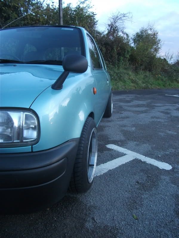

Are those the 165/55s Mark? They fit nicely under the arches but I'd like a little less arch gap than on those pics, if that can't be done with 165/55s I might have to opt for a larger tyre. Hmm why can't I know someone with exactly the same wheels as me, running 165s :(
Yep 165/55s. A coil off your -60 springs would probably do it. But running with a bit of excess arch gap will motivate you to get saving for the coilovers.
