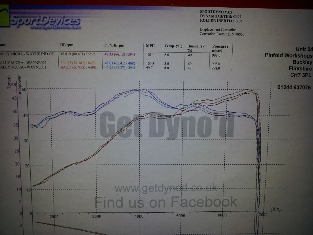

Got the Grape on a rolling road dyno today courtesy of Simon at Get Dyno'd in Buckley, Flintshire.
http://www.getdynod.co.uk/
Mods on the car are -
  • Custom cold air feed
  • K&N air filter
  • Ebb style throttle body
  • 1.3 camshafts
  • Frankspeed exhaust manifold
  • 2nd decat
  • Sportex back box
What do we reckon?
they shove a wideband sensor up the tailpipe eh, its very useful info :)
Ah, I see.
I have 2 questions, nobody's mentioned either area yet so I'll lead out -
I expected to see a dip around 4000rpm due to the 'lean fuelling' in the stock map (I read about it on here) but mine seems to show a peak in both curves there and a dip at 4700rpm instead. Anyone know why that would be?
If you're on 1.3 cams it could be that? And if that's 79 HP at the fly then im impressed, and happy cause I'm on similar mods therefore... :D

the 1.0 dyno runs i saw a couple of weeks ago were mega rich at the topend wayne (sub 12:1 !) so i dont think they suffer the lean-out in the midrange that the 1.3,s do.
baguete might have some printouts on his 1.0 blog to compare ?
Simon was surprised by the magnitude of the transmission losses, 30bhp and 17ft/lb. He said this was only typical of more powerful cars.
Is this typical for our car?
My gearbox is nice and full of 75w/80, it almost motivates me to switch to an engine oil, 5w/30 semi synthetic perhaps? I've heard it mentioned on the forum anyone had any noteworthy experiences?
i,ve been running engine oil for ages wayne, what are your tyre pressures ? because i think the dyno uses the "rundown" data when he lifts the throttle to assess the transmission losses
Yes, the dyno does use the "rundown" data when he lifts the throttle to assess the transmission losses. This is to calculate the f/w torque and horsepower. It's a shame these are the numbers we bandy around as they are only calculations and therefore have the potential to be miscalculated - sometimes by unscrupulous tuners wishing to impress their customers. Personally I prefer to consider the 'at the wheels' figures, after-all it's only those that matter.
I'm currently on a set of Yoko A021r 185/60/13. Simon asked if I had an lsd in there. I said No. "So what is causing the loud whirring sound?" "Tyres on the rollers isn't it?" I replied. "Are they knobblies?" He asked, meaning gravel tyres. "A bit, they are quieter than knobblies on the road though." I touched them and they were noticeably warm so the pressure would be higher than the 23/24 they measured just now. I purposely set them at 24 because when I compete they come up quite a bit. I've been idle by not pumping them up since my last event 100miles ago. I am aware you can make your car seem more powerful 'for the dyno' by overinflating them so it makes sense that under-inflation would have the opposite effect.

Considering my peak torque came up at 4000rpm and peak power at 6500rpm would there be any benefit in disabling my rev limiter?
I did disable it on the white 1.3 I had but this car has a different purpose so I didn't consider it so important.
I guess the question I have to answer now is which way of driving will yield the fastest acceleration. Gearing for peak torque or peak power. By this I mean changing up to drop the next gear in at 3200rpm and up again at 4500rpm ideally picking up again at 3200rpm
or
Changing up at max 6800rpm and up again at 6800rpm. This way hoping the revs never drop into the power plateau at 4000rpm to 5000rpm.
I'm guessing I might sound like an idiot here but I usually drive turbo diesels and I have a clear opinion which is most practical and effective with them (torque) ;)

transmission losses?!?! when i ran my 1.3 on the dyno (no air filter, fuel pressure reg, no back box, HT leads and spark plugs) i had 80 at the wheels but estimated 120 at f/w....... try that for size!
Hmm, No disrespect intended, I can give you even bigger transmission losses if I estimate your fw bhp at 130 can't I? I don't know your spec but in short I don't believe it. Simon's experience indicated he doesn't usually see a 30bhp difference between measured whp and calculated fwhp but he doesn't usually get 998cc Micras on the rollers either! Frank has a plot where he only lost 12hp IIRC.
IMHO measured wheel hp is all that matters and calculated fw figures are only ever that, calculated. Different dyno's work differently thus results vary. What you see above is only my (new) baseline, reassurance that the mods done this far definitely have made a worthwhile difference. Not too bad for a car that shows 97800 on the clock. It still doesn't match what ebb dude got going from his micro micra project though does it? But then I haven't done all the things he did. For example, I've paid no attention to compression figures or increasing them, yet that was one of the first things he measured and improved. I've identified a couple of reasons why my results might have been the way they were, I intend correct them and retest, maybe, if I'm lucky.
