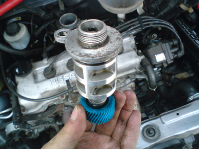

Struggling to find good info on this. The cars a 2003 k11.
I'm assuming the drain plug is on the bottom under the car. People talk about filling through a 'speedo drive' but I've never heard of this or know the location. Anyone with info out there?

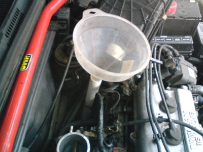

I fill my k11 gearbox via speedo hole, pretty straight forward.
drain gear oil via the 1/2" square drain plug at the bottom of the gearbox (plug has a magnet, wipe it clean of debris before installing back).
remove airbox to access the speedo cable at the back of the gearbox.
unscrew the speedo cable screwcap from the speedo gear module by finger (may need a big spanner if its stuck).
unscrew the 10mm bolt n pull out the speedo gear.

stick a long tube & funnel down into the speedo hole n fill with gear oil (bout 3L i think).
k550i-1628-jpg.32457
check the level by sticking the engine dipstick down the speedo hole till the level is at max.
reinstall the speedo gear, cable and airbox.
