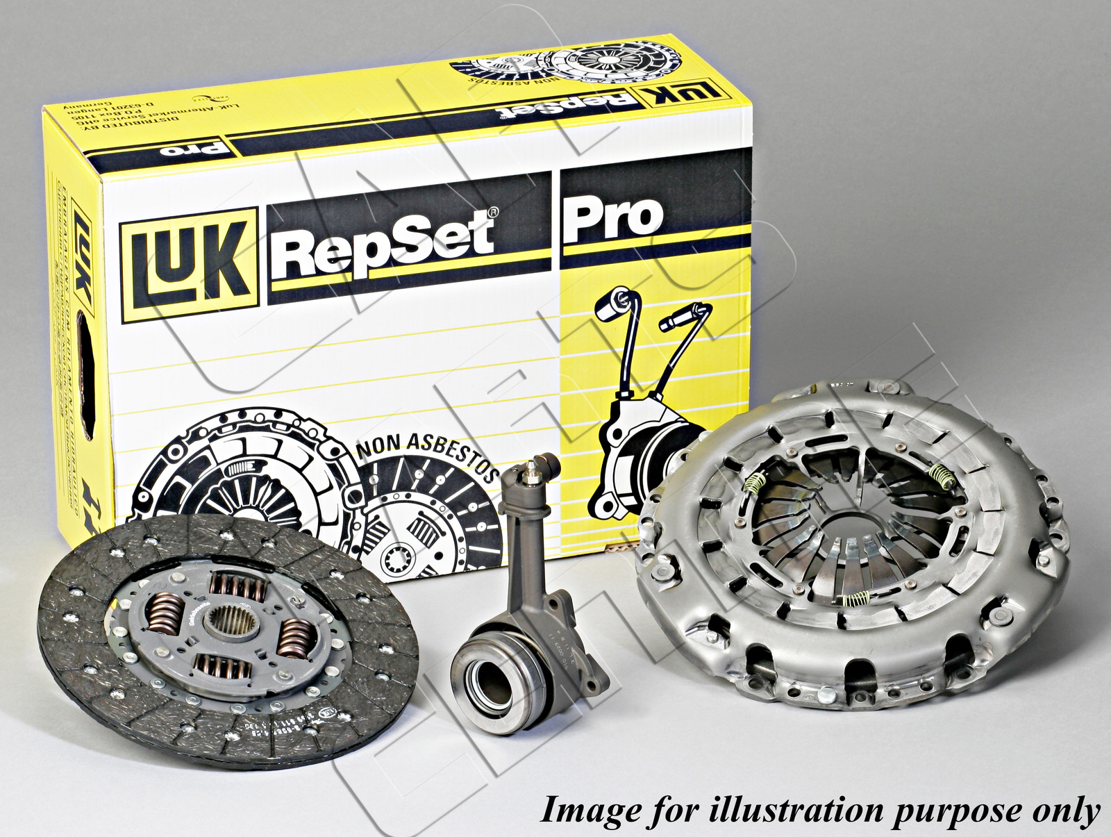

(from a woman driver who obviously never put the car in neutral at traffic lights etc, but rode the clutch). One of the flat pressure plate support springs broke, causing the diaphragm to twist and the clutch to drag and barely release. I (and a mate) removed the gearbox and fitted a new 3 piece LUK clutch. And yes to Max, the K12 does have a hydraulic clutch release mechanism, it is a co-axial slave cylinder with integral release bearing,
also all changed with the new clutch pressure and friction plates...

I have looked at the LUK clutch kit and they are really cheap as well. Always a bonus. I suppose I can always look at the mount during the process and see if it is in need of changing
