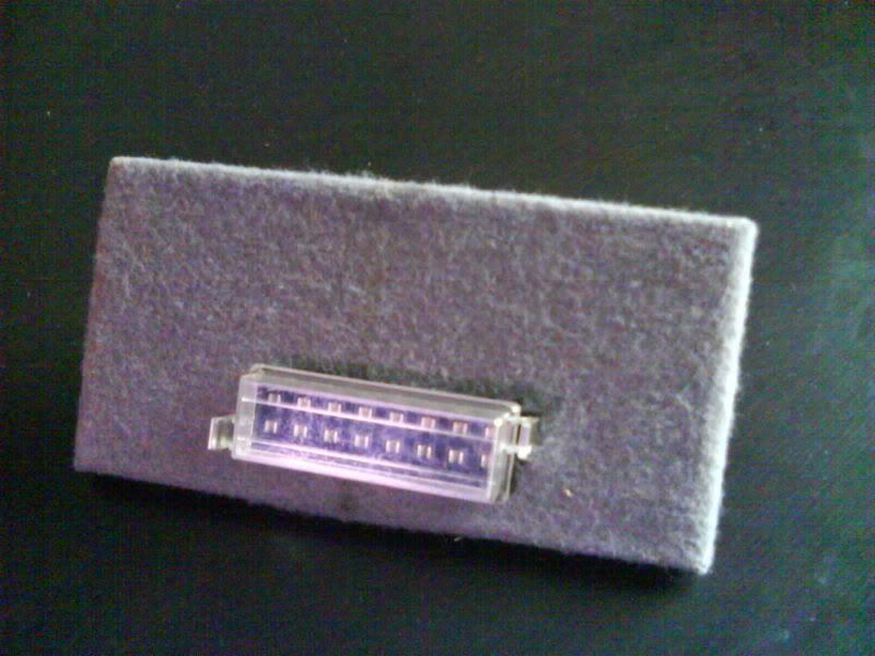

I've just bought this fusebox so I could individually fuse each appliance/thing:
http://www.autoelectricsupplies.co.uk/product/311
It didn't come with any wiring diagrams or anything, and I was wondering how I should connect it in. I've got a lead coming off of the positive battery terminal I'm going to use, but how should I connect it to the fuse box? Will I need to split it and run it to each of the fuses? If I did that, I'm thinking I would then connect said appliance to the other connector on the fuse box, and then run an earth cable to the bodywork?

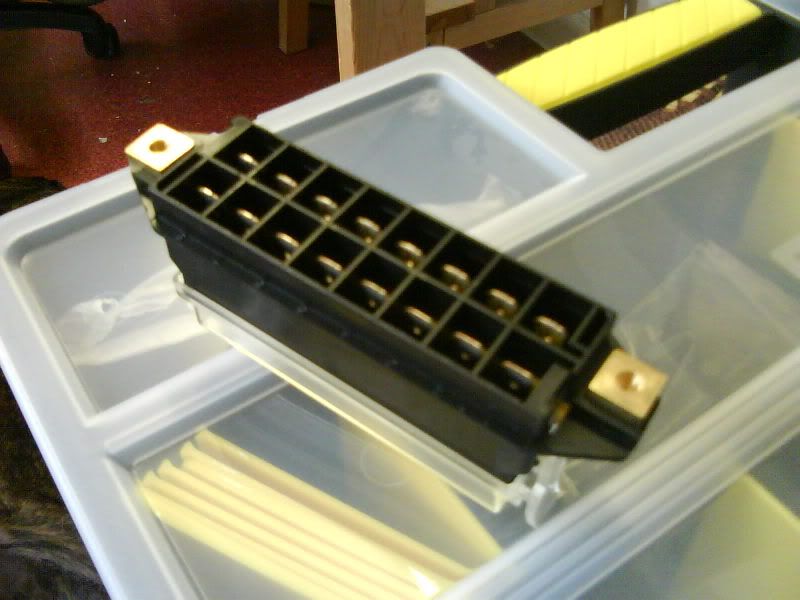

Thanks for the reply and explanation. Here's a pic of the bottom of the box:
I can't see any main power input. It looks to me like I will have to split my positive lead to each of the connectors, and then attach the appliance to the other side, running the earth off that to the bodywork.

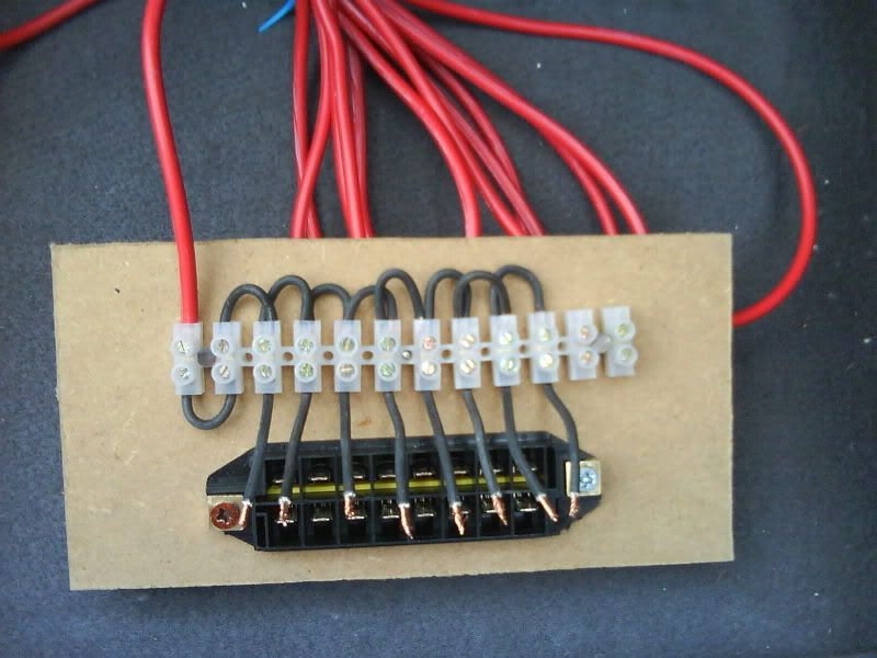

Until i get a better setup like in that link, here's what I've done.
It's not connected up yet, so if theres a problem, shout, and it's not the end of the world :laugh:
The connectors will go on the ends of the black wires, and then plug into the fusebox.

Yep that looks perfect to me (Y)
BTW, instead of crimping the ends of the cables, why not solder them directly onto the fusebox terminals instead ?
Its certainly a lot cheaper, easier, and quicker too.
Just leave the crimping if you prefer for the output side.
Tip: use the spare 2 connectors on the terminal block for the ground connections - will keeps things neater by preventing having loads of wires everywhere (you can add an extra piece of terminal block if required).

I think I might just do that :) Thanks for the tips.

Also, if you have a multimeter handy - stick one of the probes into the screw terminal of the red main power cable and check for continuity of the connections at the fusebox end - not totally necessary but avoids headache later on trying to look for that dud connection...
