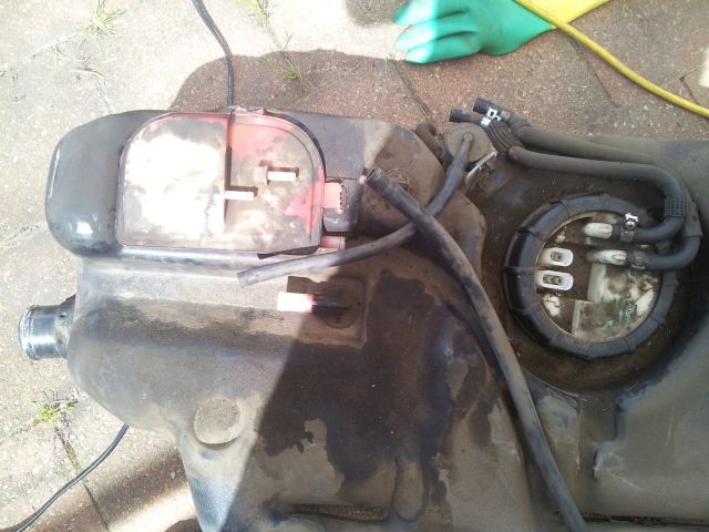

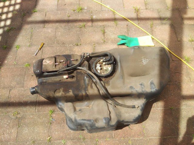

my 95 has a major leak, ive pulled the tank out & discovered its the little pink/clear/white tank that sits onto has a massive crack in the bottom.
what ime looking for is part name & part number
if it can be replaced without pulling another tank from another micra
whats holding it in, looks like glue but i don't want to rip it off to find out its clips and cant attach a new sub tank
so..... il take a wild guess & you guys don't have that sort of fuel tank in the UK... im having trouble finding 1 here in aus as well very odd, il post a pic so you can see & maybe you guys could give me some insight on if this kind of tank exists somewhere in the world other than in my micra

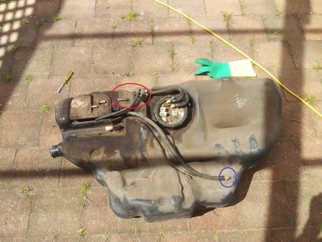

this is my thought of bypassing it to make it work, basically id connect the little canister looking thing in the red circle to the plug to the tank also in the red circle, block off the 1 in the blue circle, & connect up the fuel pump & fuel filler vent as normal any thoughts?
