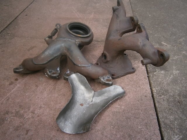

Can someone explain what is this frankspeed manifold? as far as i know it is a standard exhaust manifold modified, but i do not know what are the moifications about...
Frankspeed on the left.
mani-s-jpg.21682
I'm posting this whilst the forum isn't showing what I'm typing, So I hope it comes out. Cut the front off the manifold and weld on the plate. You can see the difference in these photos.
