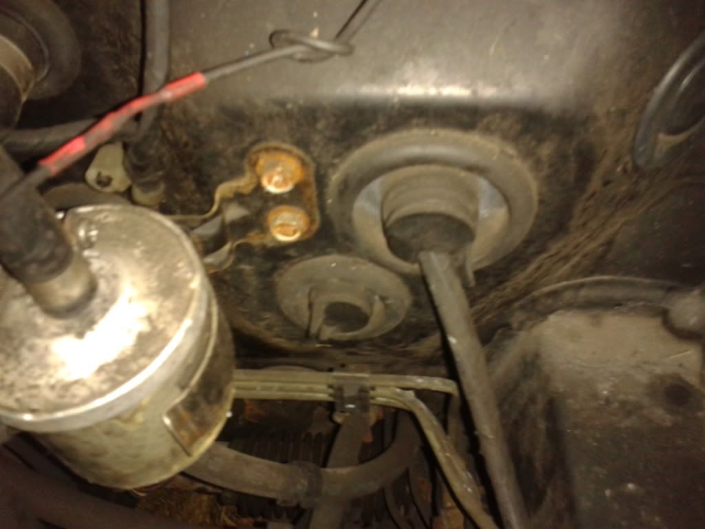

when i was looking around the engine bay yester i found a wire tucked away under the coolant i think basically at the bottom right conner :) and their is a red and a black wire i will take a picture today after i come back from school and put it on. please help if you know what it is. also how would you flush the windscreen because the water with the windscreen washer has became stail and it really smell :glare:
Be good to see a pic of the wire for a diagnosis of what it's for. I'll have a nose once you've put the pics up!

right i have a picture i will put it on know

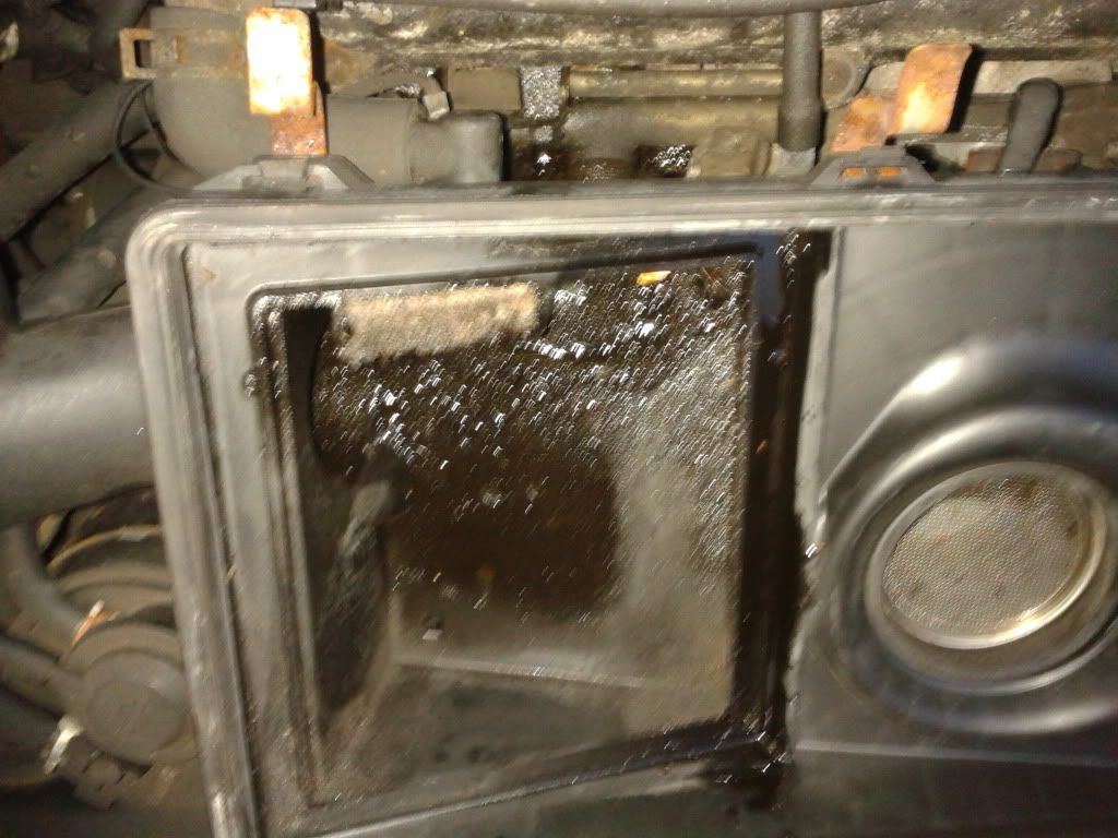

i found another problem :( in the standard air filter box :/
basically the wire going into a firewall which means it something inside that was powered by it but hell know what :(
also as you can see the airbox is filled with oil can anyone tell me why that problem has occured :)

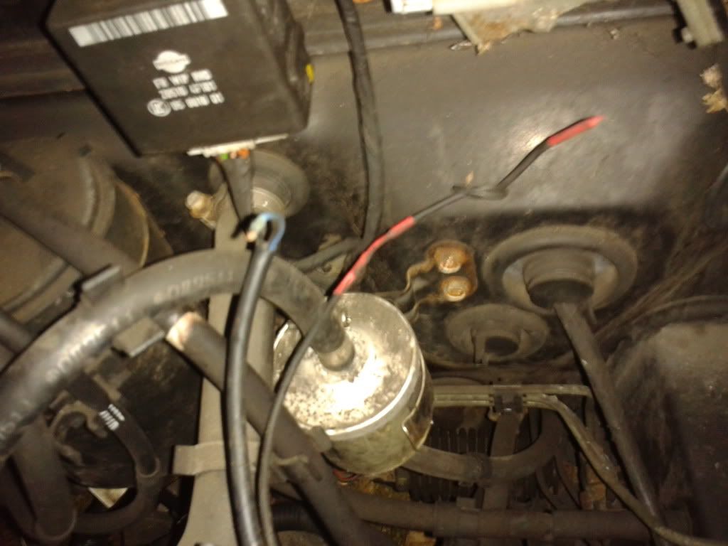

i found the blue and red wire tooked under the coolant carefully. i find that they try and hide any problem
the oil in the airbox is caused by crankcase oil vapours thats flowed out the pcv breather pipe (prob due to excess blowby during full throttle), saturated the square pcv breather filter till it all pools inside the airbox. during services the pcv filter should normally be replaced if soaked up but this ones obviously been ignored
yes and it only passed it test in june i think. but is that okay then or not ? because if not then what should i do because when i get enough money i am getting a cone and a little filter for that pipe aswell :)
also i will pull the full wire through and then have a look were it lead too :)
and then report back tomorrow :)
