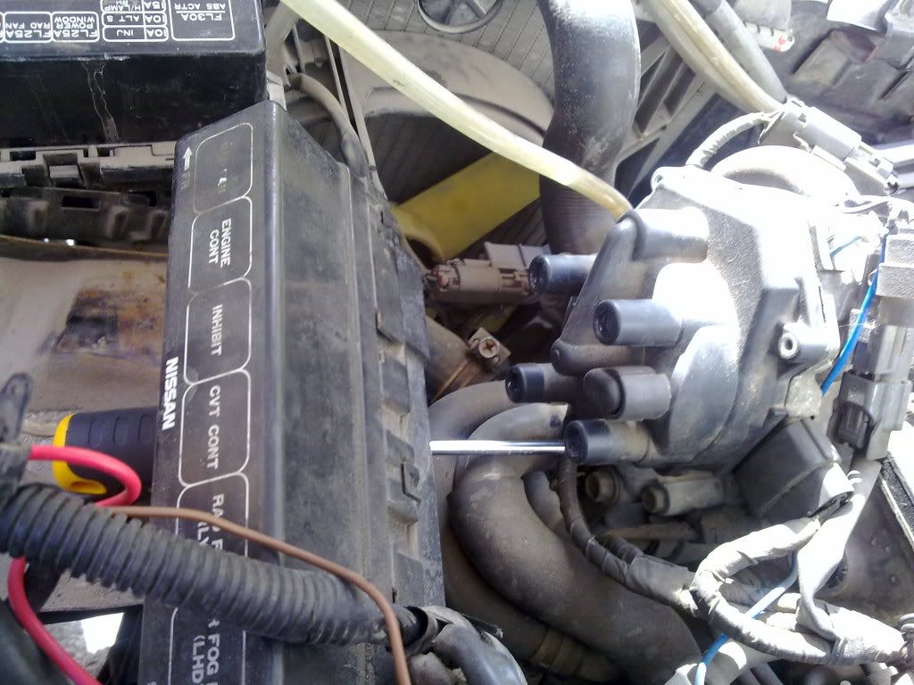

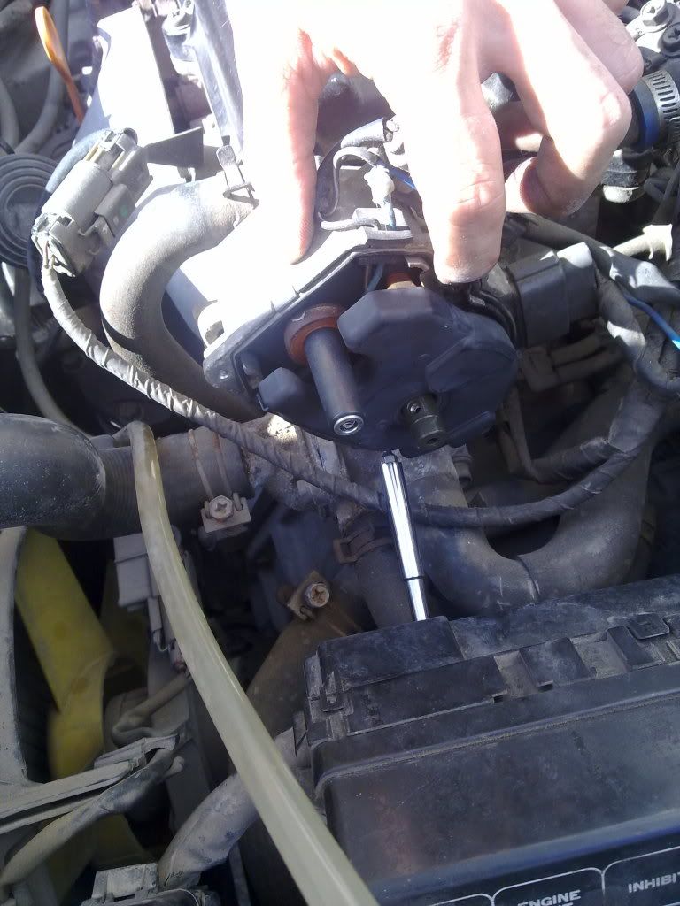

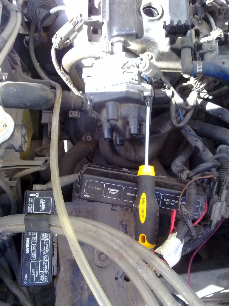

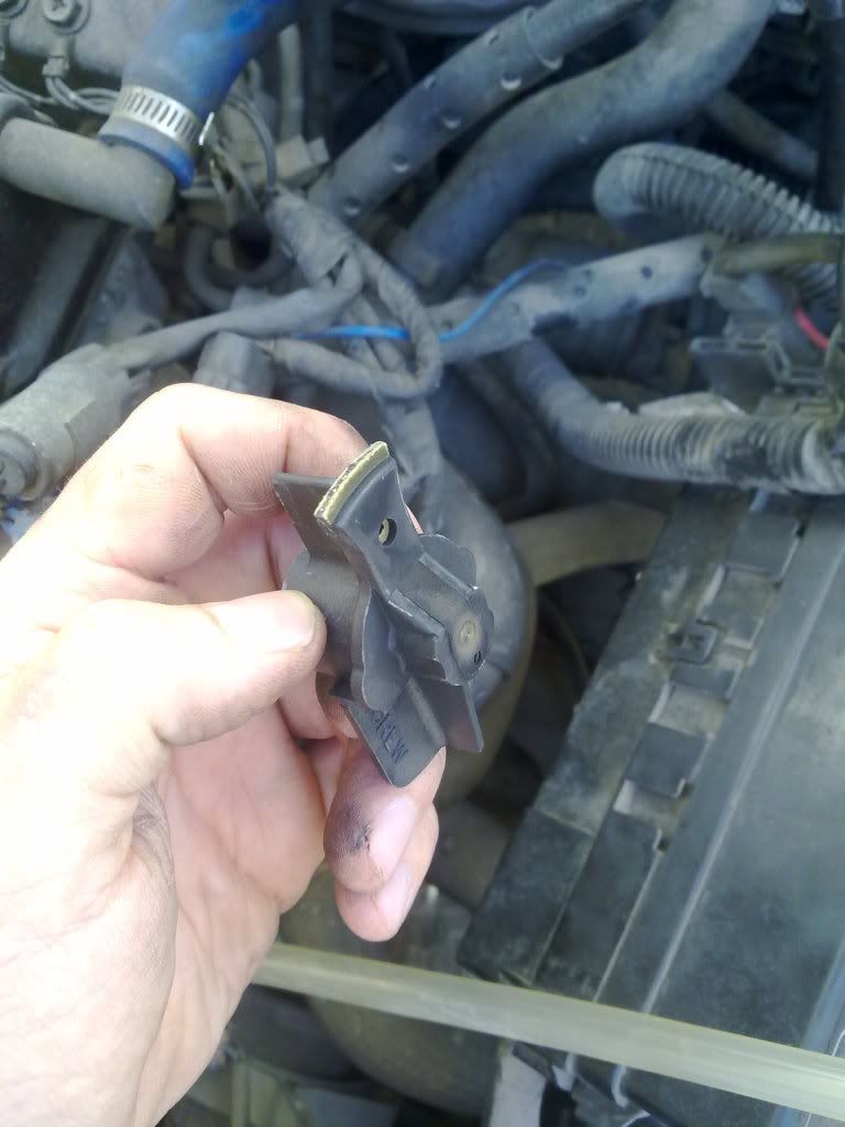

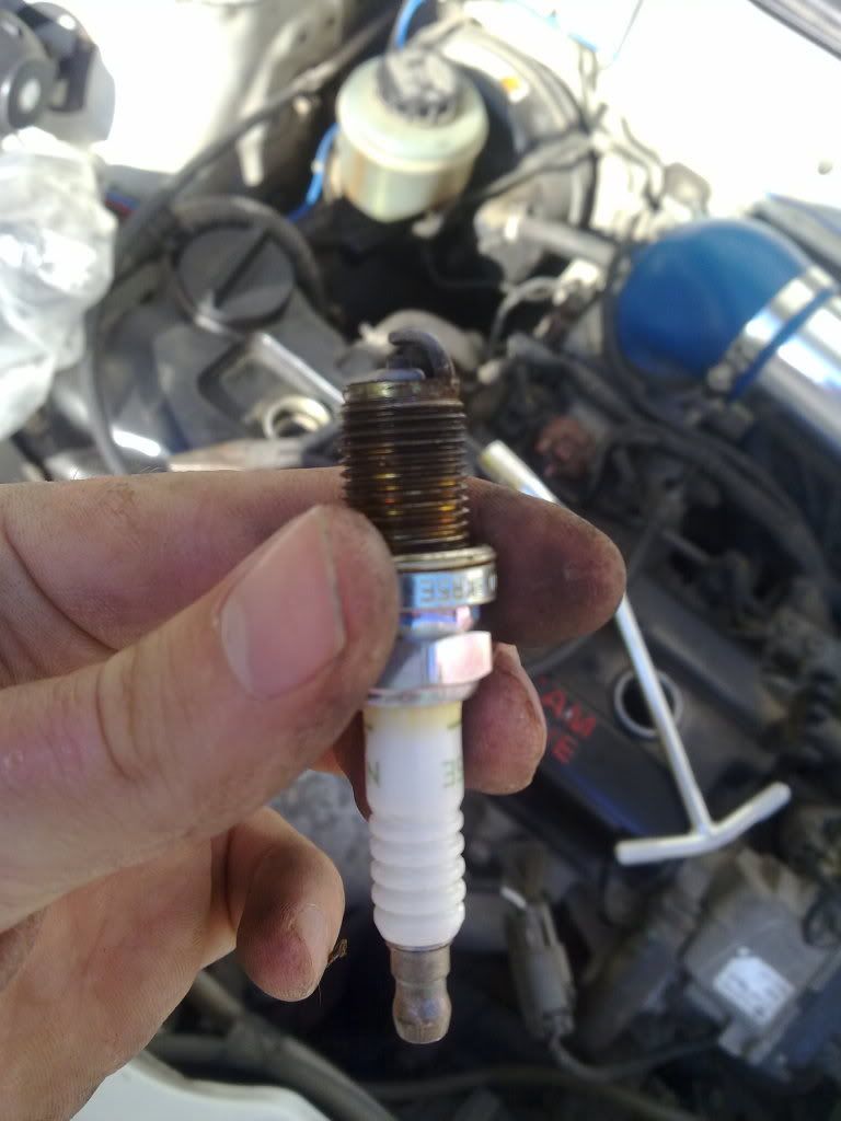

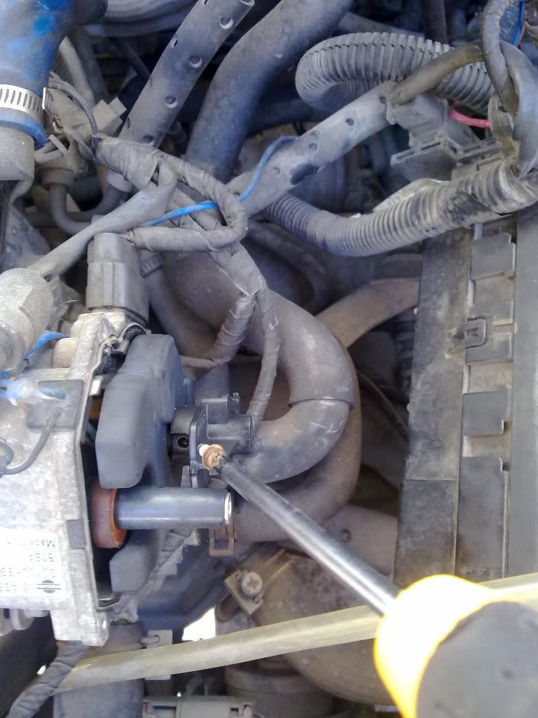

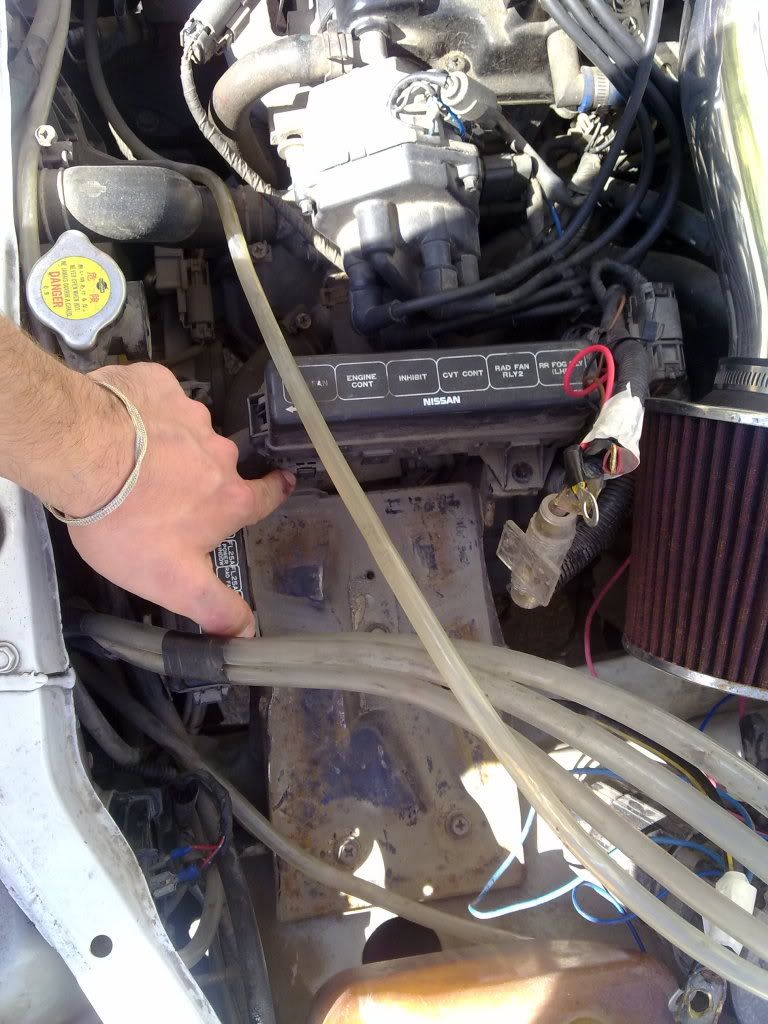

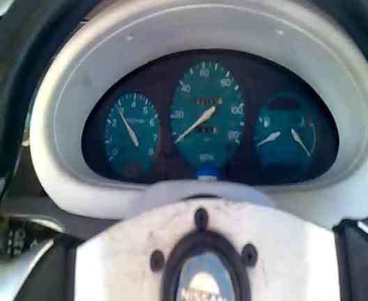

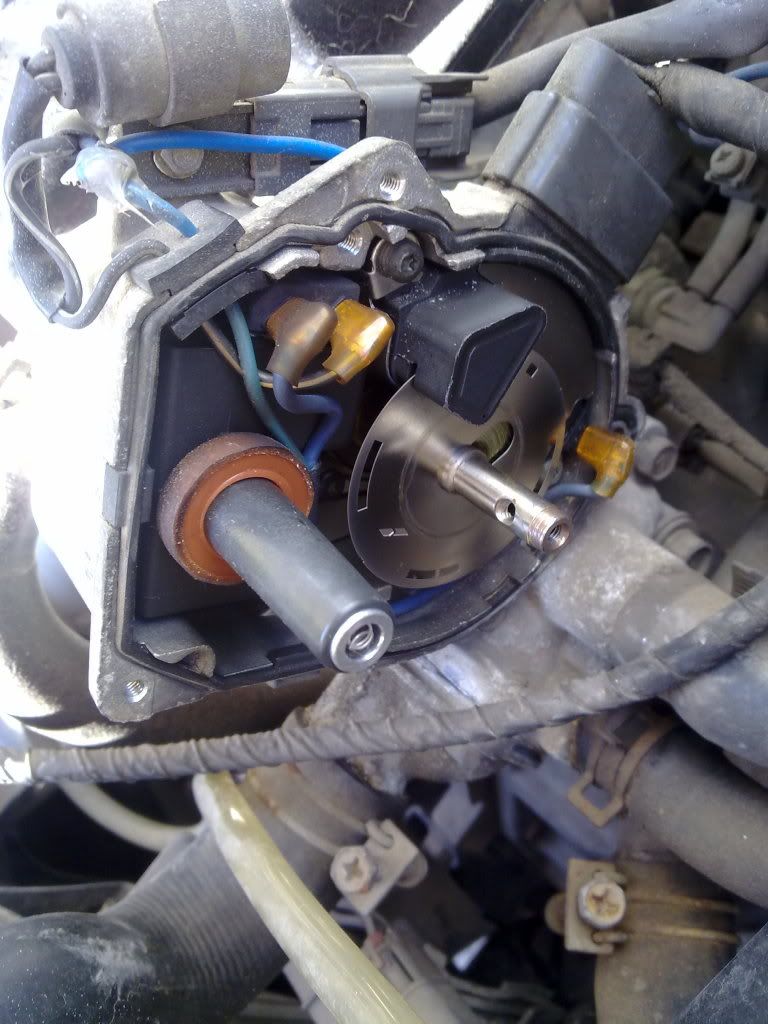

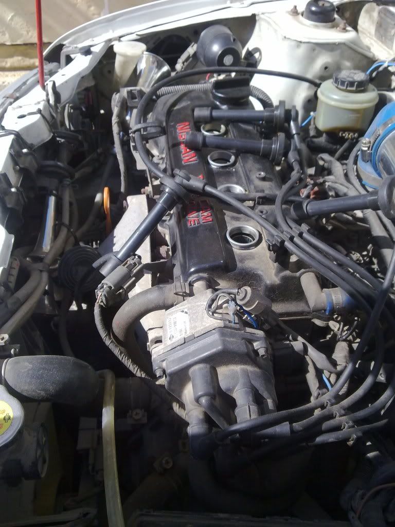

Thanks to TONYSLX I've attached some brieg photo guide on accessing the dizzy.. mine's a 95reg K11 1.0L recently have been having severe etuttering and worse even kind of explosions/backfire beneath engine due to wrong firing due to distributor never checked or replaced and rotor arm in 14yrs. parts are on the way but after cleaning already improved... now I have funny rev meter readings but everything should be fixed when cap and arm arrives..
Thanks micra sports and thanks Tony once again.

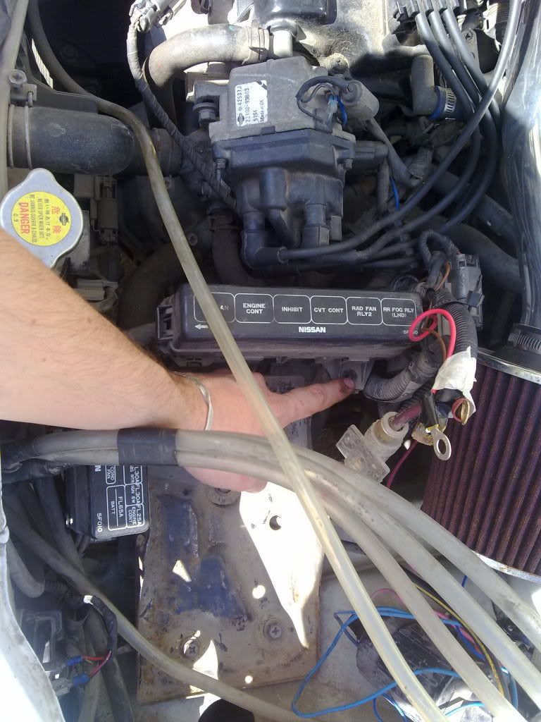

I'm pointing with my index finger where clips or screws are.... for those new to the fix like I was....
Battery hjas to be removed and fuse enclosure unplugged from clip and screw

Ok heres what i think is happening to the rev counter ..... It looks like you have a rev counter wire added / spliced in to the ignition wiring ...... its the blue wire shown best in the tenth picture down with a glob of what appears to be sealant over it .... check this is a good connection .......... its been added and thats why its seperate and not inside the wiring loom but feeds back and is tied with cable clips ..... check the entire length of this for chaffs and short circuits (That is what it looks like to me ... i could be wrong and this could be a standard wire .... but i suspect its been added )
I suspect your cleaning up the parts a bit has disturbed it ... and what you might be seeing is the leaking sparks in the cap discharging into the blue rev counter signal feed wire ... thats my guess .... the new parts should correct it ..... imho .... or worst case the dizzy coil is on its way out but i think that very unlikely .... due to being abused with a 14 year old cap and rotor lol :) ........
I am not an expert on this ... so perhaps some others will have some feedback ..... like i say with that old cap and rotor my bet is the high voltage output of the coil is dancing about and going everywhere but where its meant to inside that cap..... like a disco diva :)
