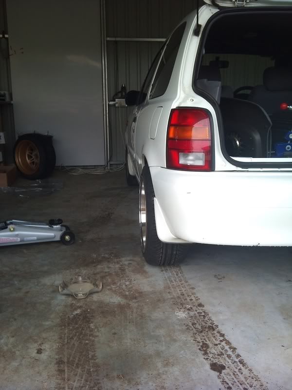

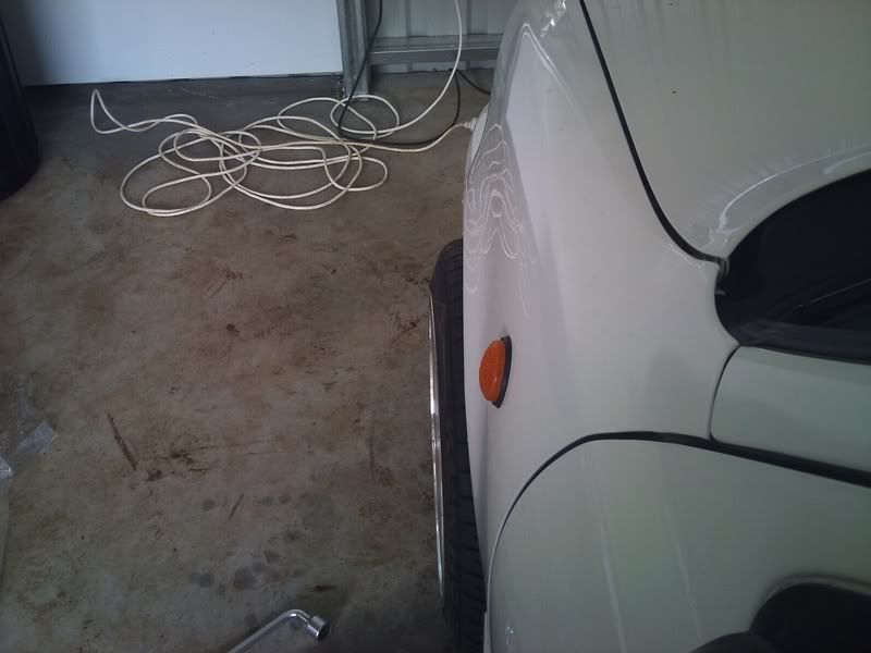

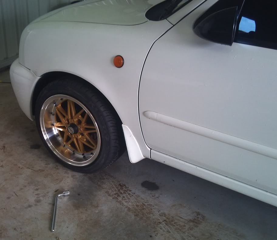

Took them to get tyres fitted today, also tracked down some hubcentric locating ring thingos and had a crack. I knew they would be too wide, so was more trying to work out how much elbow grease I have in front of me..... anyway, a few pics.
The rears aren't too bad. With some guard rolling and a little pulling of the guards, I am hoping that I won't need to do any extra bodywork/flaring.
The fronts are going to take more work. I picked up some camber bolts this arvo and will need to get the heat gun out with the guard roller to push the limits a bit.
Also, the rims aren't bolted up tight in the photos. I only had stock nuts, and couldn't get a socket/wheel brace over them, so they are just finger tight, and still quite loose. So that should drag a few extra mm out of it too.
Any tips on rolling the micra guards guys?

i think you will just stretch the lower doorgap with an arch roller personally adz
my red one was fouling on the offside only, even with a lot of camber ( probably more camber than your camberbolts will give) and i had to take the wing off and bash the front of the flitch downwards (so that the front of the wing sat lower and the arch "bellied" outwards for more clearance)

Well after putting in the camber bolts, rolling the guards quite aggresively, I am pretty happy. Whilst the rims don't sit inside the guards, the top of the tyres sits inside and I can't see too much hassle from the plod. The car will only be getting driven 5 days a month or so.
It will be going about an inch lower once I get myself some coilovers. There is absolutely no scrubbage at this height, so I am hoping another inch with much stiffer springs won't lead to too much messing around with cutting/bashing/etc etc.
xsoarerx: they are 195/45s. I am happy with this tyre size, and not going to any narrower/taller in the sidewall to get any more stretch. I guess the biggest thing with the rear camber is the idea of hacking up my axle and then guessing how far to bend the hub back to get the camber. It seems very rudimentary and frought with ****ups.
