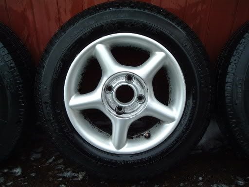

Here are the pictures, they have been washed only in these. This is before they were cleaned or polished, to remove break dust and make them shine :)
They do have centre caps and will try and get some pictures of these soon.
The rims say that they were made by wolfrace and the centre caps say "Sport Racer" on. The tyres are 2 Continental Eco Contact and 2 Pirelli 2000 Plus. Do these tyres normally give much trouble?

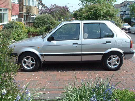

Well they fit on the car, just fine and it now looks well low at the back. They only rub slightley when at a roundabout or turning a corner hard, but some bump stops will stop this, no worries.
13" rims are a bit small but look so much better than hub caps, overall I'm very happy with them. When I get around to washing my car I will post a picture of them on the car.

I bought Artec 13" alloys couple weeks ago... I was searching for 14"... but these were a real bargain... and they look also nice :)
The alloy is pretty much dirty on the pic, but thats the only pic that i've got... Today we have Nissan Club Poland meeting, so the car will be shining ;) I'll do some pic's today and post them later :)
